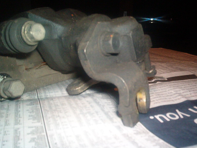

o.k so ive installed an AE86 rear end into my AE85, found that when I installed the handbrake cables I was missing the last bracket that bolts to the caliper. After some searching I was able to purchase the brackets off a T series rear as they have the same calipers, but after alot of stress and trying to stretch the cables to fit have decided that these brackets are longer than what they must be on an AE86.
How you can help.
Can someone who knows the brackets im talking about and has an AE86 rear end with disc brakes in an AE86 measure the total length of the bracket and let me know what that measurement is. Measurement from the face that sits against the caliper to the outside face on the other end.

I think you are referring to this bracket, in the foreground?
[img name=]http://www.aeu86.org/files/im/im000379_544.jpg[/img]
If yes it is 29mm from outside to outside, i.e. face where it bolts to the caliper body to the face of the recess where the cable slots in.
Maximal length is 70mm which I would think fairly important to ensure proper alignment.

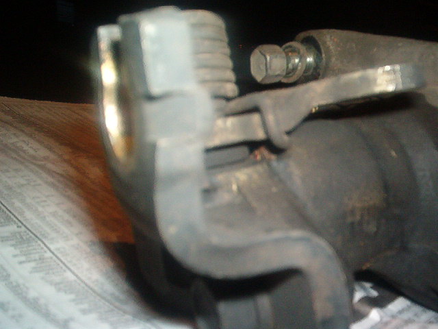

[img name=]http://www.aeu86.org/files/im/im000378_131.jpg[/img]
If you mean the bracket the clevis pin goes through that pivots against the spring, that is fractionally over 11mm face to face

Thanks so much Parrot. 29mm. Its alot smaller than the one I got off a TE71.(about half the size)
