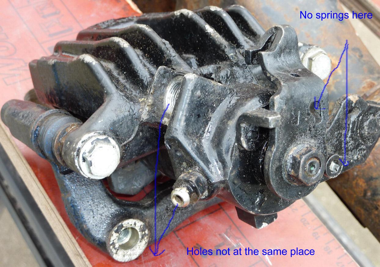

I think I've found my problem : I'm not using the correct caliper , despite it's from a Golf IV . I've noticed on your pics(NoHachi) that you have an external spring for the handbrake lever.
Mine has an internal system . That's not the trouble . The caliper sub-assy(support) is different from yours .
Got some pics :
I must find another caliper , but don't know what to look for , as it seems there are two models .
Will inquire next days .

yes its a different model. maybe search for audi a3 / a4. my set was from an a4 afaik.

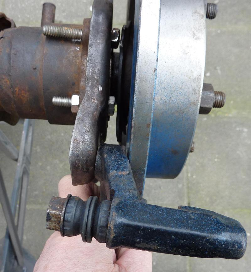

Got caliper support from I don't know Golf , Audi , as it was out of car.
Tried it , but now ,if I center the caliper support with disc , there is too much room to reach the stock ae86 bracket.
Do you have to put washer between bracket and caliper support ?
Or I guess I don't have the good caliper support again .
Really hard to find ...
Fil

yes i had to put washer (actually 2 of them for one screw) between the caliper support and the bracket.
