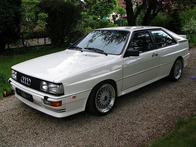

Hmm.... reminds me more of the Audi Quattro with his stock body Big Grin
Very nice work Thumbs up! love it Smile
