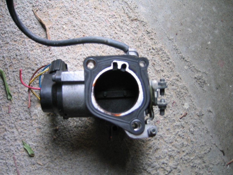

The manifold side is the same bolt pattern, but the airhorn side has a slightly different bolt placement (close though). Here is a picture of blacktop gasket on silvertop itb (manifold side) to illustrate the difference. As you can see the bolts overlap nicely.
'85 AE86 4AGE, '94 SW20 3SGTE, '83 KP61, 72' RA21 |

A fairly quick and short offtopic:
On the last pic - that's the TPS on the left with the wires hanging, right? |
03-03-2007, 07:57 PM
AE 101 - 111 ITB Question, please help
Yes it is.
