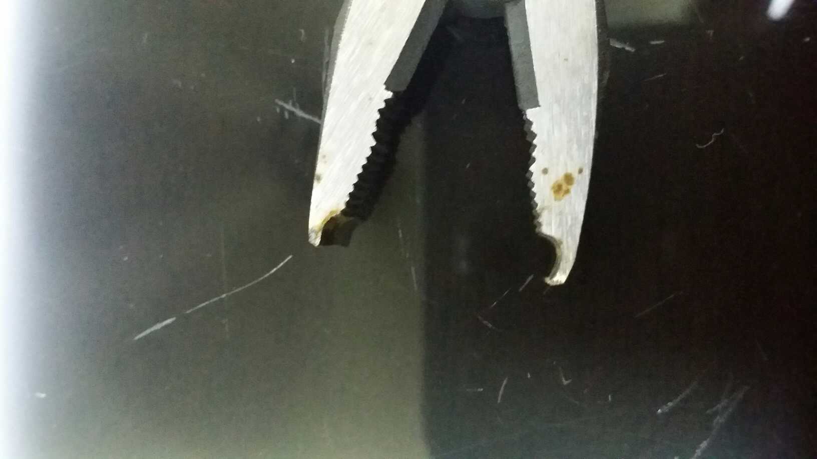

[Image: AEU86 AE86 - 4AGE 16V engine overheat wh...high speed]
The front end grinded as below photo

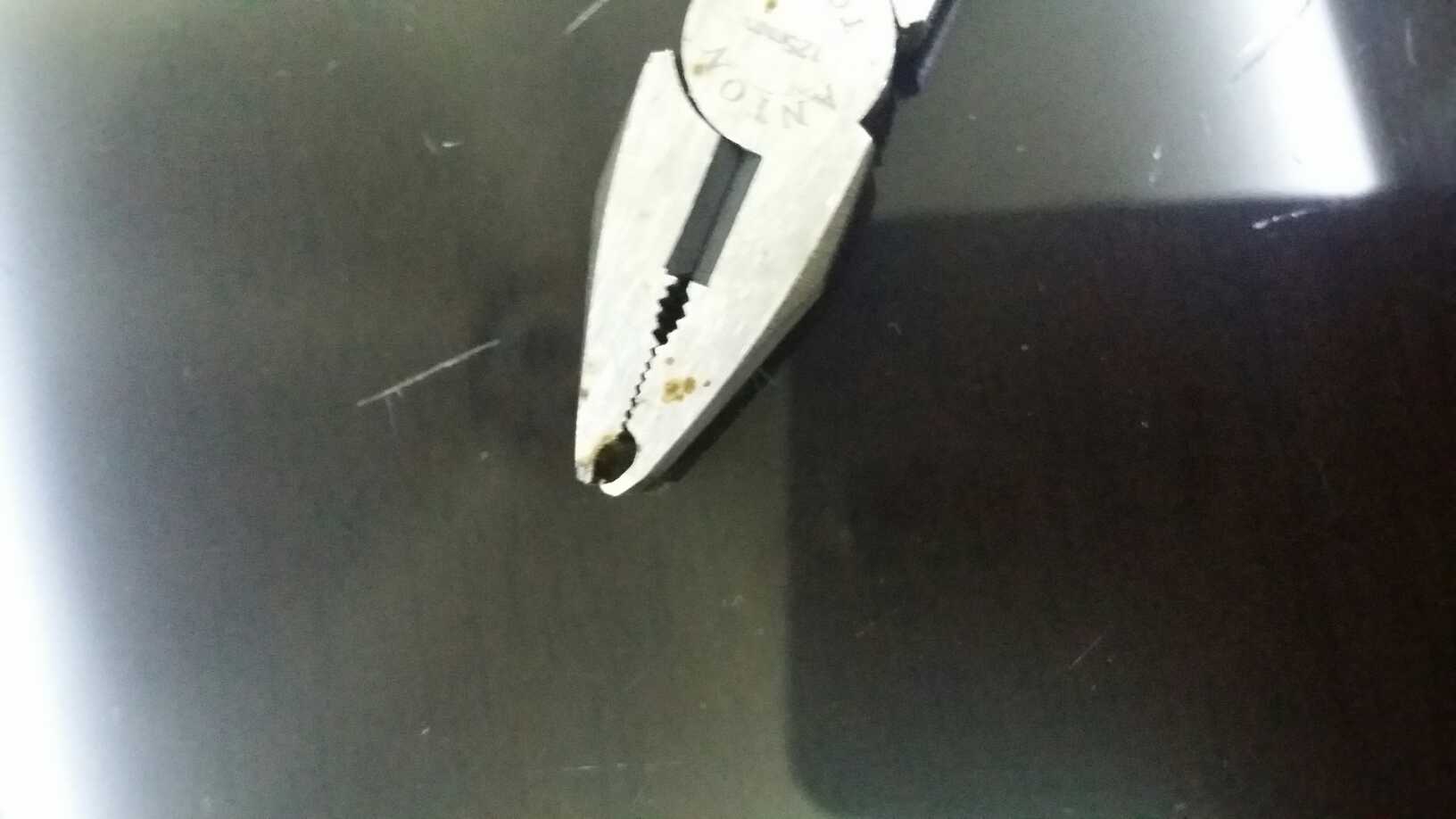

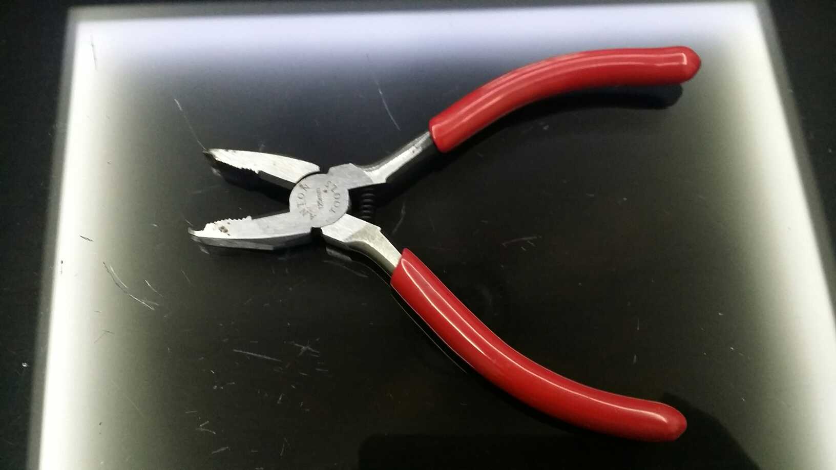

This piers is to dismantle the radiator cover.
To put it back just use a standard "adjustable locking plier"
Tq
