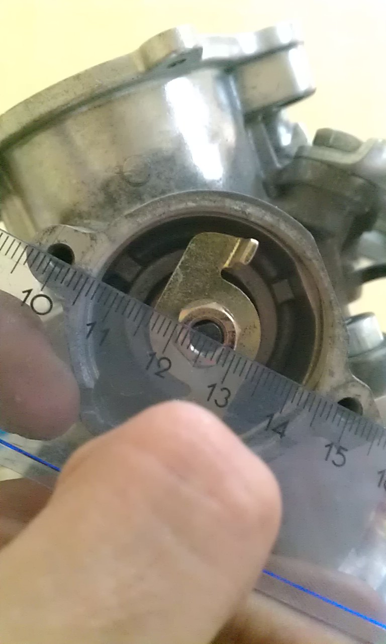

Do you know the story with the TPS on the itb's Bean,
can I use the smallport one that I have fitted at the moment with the
itb's ?
not sure about the TPS as I got my ITBs along with a 20V TPS and running Standalone I didn't care. According to Toyodiy all models 86, 92, 101 and 111 all have different partnumbers... which doesn't mean much - try to find a picture of how they mount and attach...

ae86-92 tps's are only differ in the connector,
ae101 and 111 tps's works with the same resistance etc but it has the wires "upside down" so for example when you want to use the ae111 tps with an ae86 ECU you should change the wires direction with 180 degrees.

you should be good then, as long as the resistance is the same. Just use the smallport TPS and wire it correctly to the freedom ECU to match the schematics of the Freedom ECU and TPS.
At the end of the day the TPS is just a potentiometer, so if your not sure which wire does what use a multimeter and measure resistance while moving the throttle.

The AE92 TPS I have fitted is already calibrated for the Freedom ecu
it is more a question of physically fitting this TPS to the itb's I guess.
12-11-2012, 10:05 AM
20v itb inlet manifolds
totta Crolla Wrote:The AE92 TPS I have fitted is already calibrated for the Freedom ecu
I'll have a look today and take some pictures of the ITBs and the TPS (AE101) so you can compare.
Here we go:
[Image: AEU86 AE86 - 20v itb inlet manifolds][Image: AEU86 AE86 - 20v itb inlet manifolds]
click them for bigger versions

Reckon you could measure the spacing between the two
fixing screws for me ?
12-11-2012, 05:49 PM
totta Crolla Wrote:fantastic Bean,
thank you very much Thumbs up!
you are one lucky man, just caught me in time as I'm sitting now already in a plane writing this Wink
50mm on the dot.
