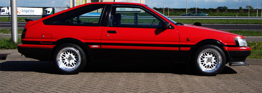

08-10-2008, 07:29 PM
Post: #248
oldskull's Levin
Some update
08-10-2008, 07:56 PM
Post: #249
oldskull's Levin
jeps on your car way better!!
08-10-2008, 08:01 PM
Post: #250
oldskull's Levin
but still its look sooooo big like I got 16" rims now 1985 AE86 (ハチロク) Levin - Summer time daily driver |
