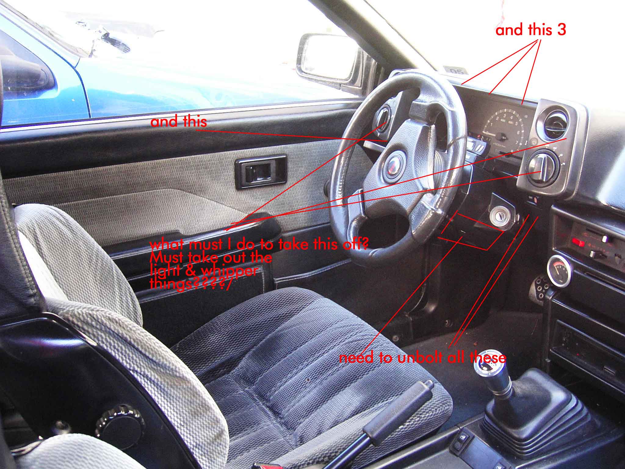

but besides I 've allready spend some time unscrewing every bolt on the down half of my dashboard do to the turbo timer and hallmeter instalation, I havent managed to do the same with the upper half.
Plz check pics and help me:

Okay..I've been there a few times. To get the part around the gaugecluster of there are 3 screws above the cluster (underside of overhanging bit of dash). You can pull off the light and wiper switches, underneath are some big nuts, take those off and you can pull off the part of the dash without any problems. I've only listed the bits that arent obvious, any other nuts and bolts in plain sight should also be taken off if they attach to the dash.

thx i'll inform you soon

Yeah sounds pretty much like what I did.
I had some problems with the steering wheel getting in the way when I took out my instrument cluster though...

he wont have that problem with the smaller steering wheel he has.
Anyway, I managed to get it in without breaking anythin on senna's car, so it is possible.
