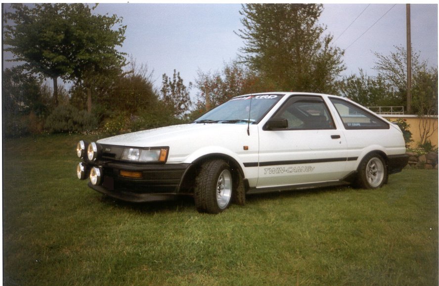

i have had 205/60-13 and they drifted fine. lasted maybe 30mins. i also have used. 165/70, 165/75, 175/70, 185/70...the only thing is that they generate heat faster because they spin faster. so if you drift for 30mins straight. you will chance the tires to blow from over pressure. usually they ruptured out the sidewall. i didnt care to air out the tire after drifting. i just run them until they blow. good thought to keep in mind.
but after a while, 13 is just too small. sure tires are cheaper. but 15s look nicer on 86. and better for higher speed drift. also, 13s have a sloppy sidewall. and bounce too much for drift. even if you stretch the tires on.
