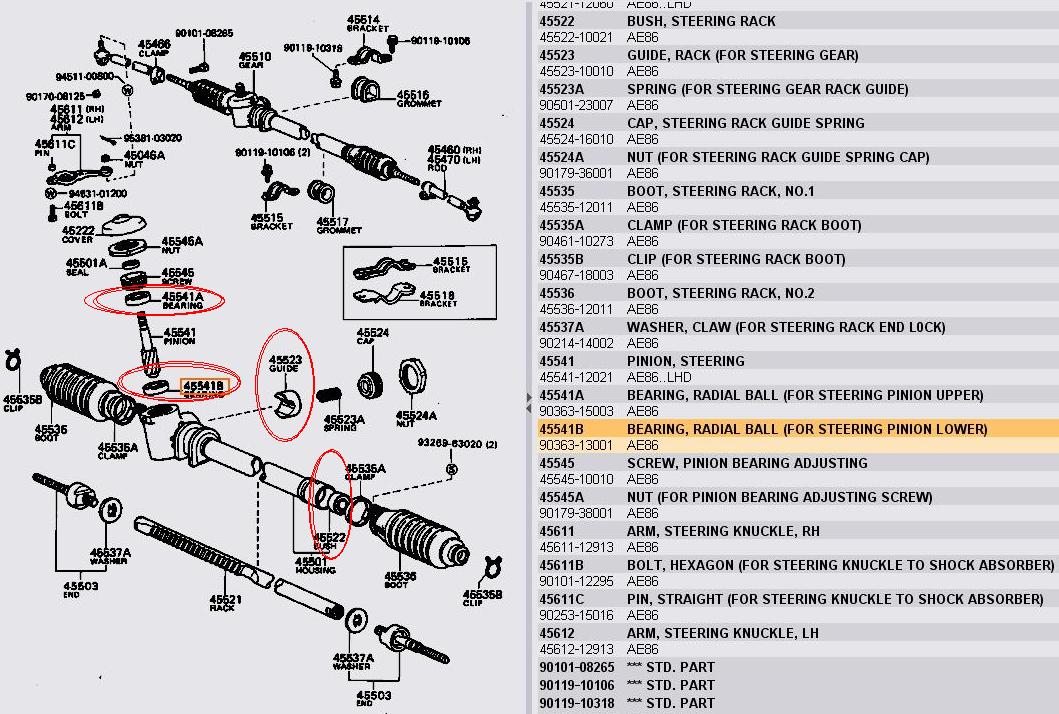

I was checking on my ae86 the steering i see that it is possible because of annoying rattling noise when i drove on bumps that i have worn:
45503 END SUB-ASSY, STEERING RACK
45503-19015 AE86
I already changed the tie rods for new one.
The question is can there be somethink other wrong. Or what mostly can go wrong? I will replace the end sub-assy, steering rack tomorrow anyway but i was wondering if this will be the only one problem i can have.

Manual rack ?
If so it could be an adjustment problem or it could be a worn bushing in the rack housing.
Bushing is at the opposite end of the housing to the pinion and if it gets worn the rack can move around causing a knocking sound.

Yes i checked and the bushing is definitively worn but as it seems there are also bearings also that are a little loose so it seems i need to change them also, don't know if i need to change the rack guide. I need to ask by toyota dealer for prices on the bushing and the rack guide i think the bearings i can get in a specialized shop. Anyway if i want to replace the bushing how to do it in proper way?

Oh btw. i checked the toyota dealer today for the parts. I was not suprised at all about those but it is really a steal what toyota dealer have for prices on those parts.
part list (without tax 19%):
45541A - bearing radial ball (for stearing pinion - upper) - 42 euro
45541B - bearing radial ball (for stearing pinion - lower) - 69 euro
45523 - guide, rack (for stearing gear) - 9 euro
45522 - bush, steering rack - 33 euro
I checked the bearings they are NSK brand but in a specialized shop they told me they are not tipical because they don't have standard sizes. They cost only 5 euro! each but are 1mm more slim like the original one's.
Paying 69+42 euro for 2 small bearings Angry because they have no replacement i am really mad.
I think i go with those from shope hope i will not destroy anythink on stearing gear 1mm will propably don't be trouble anyway.
The rack guide and bush i must order by toyota dealer i think i will not get replacement for that.

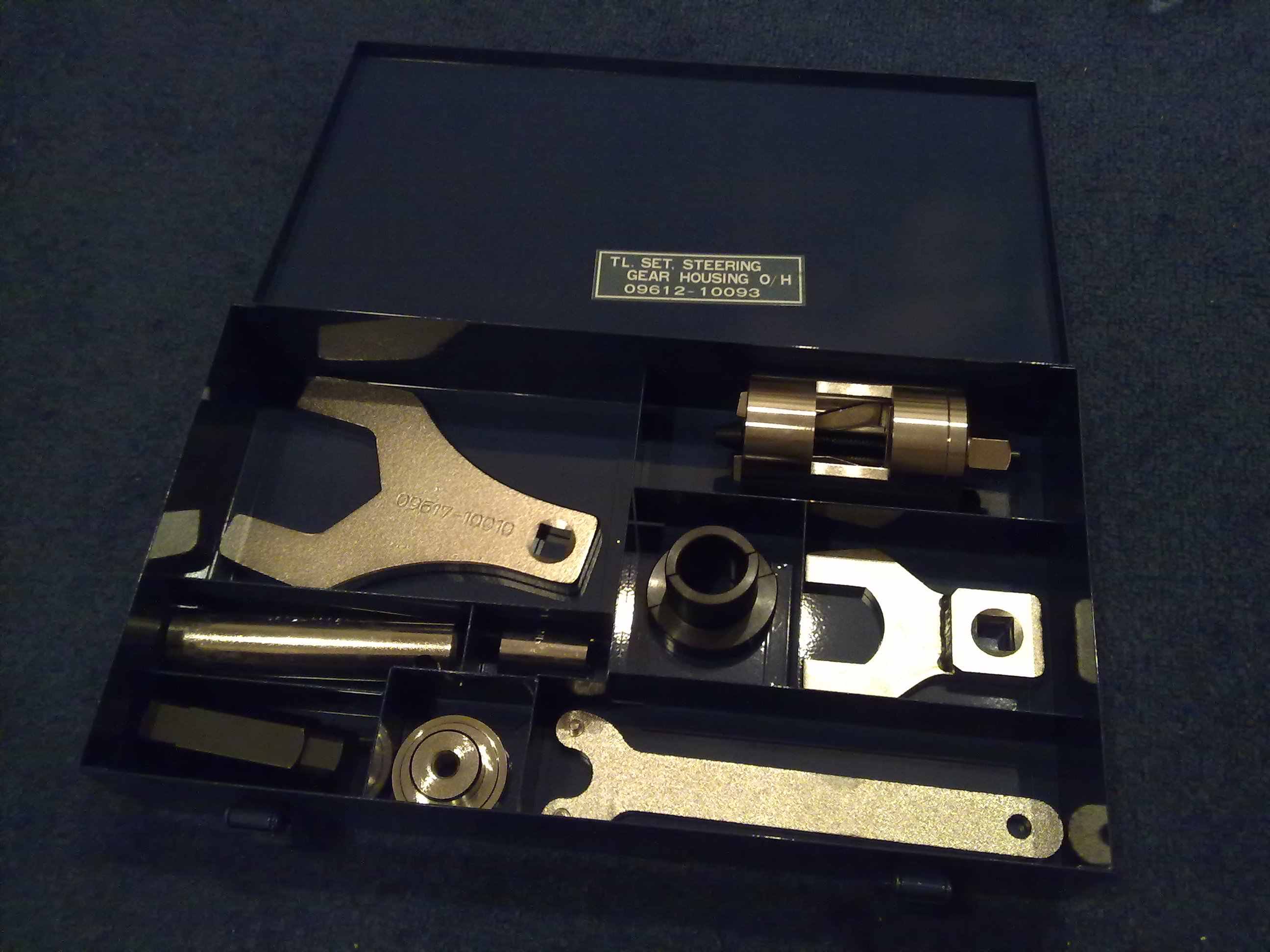

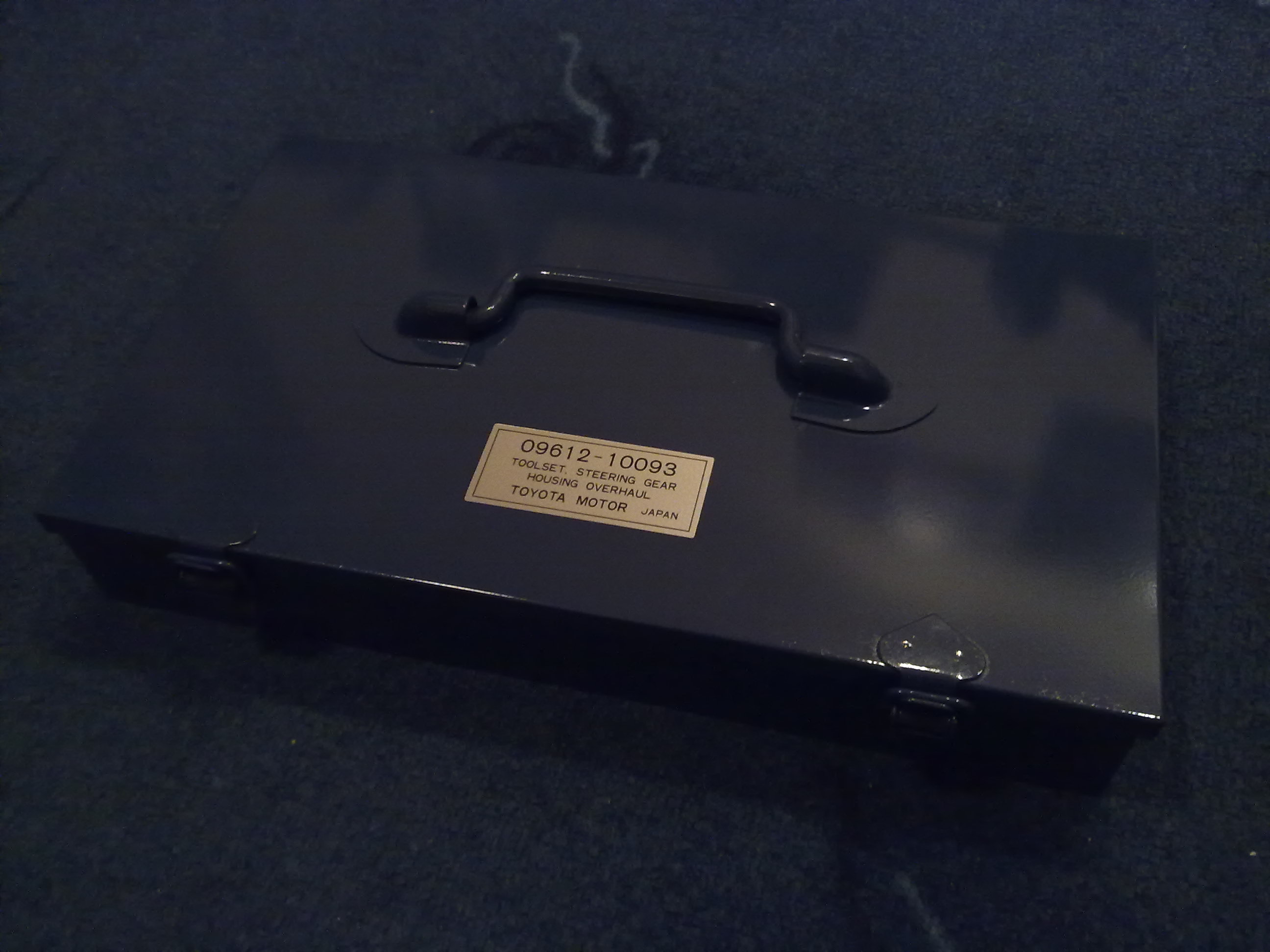

So how is looking steering gear housing overhaul tool set you can see here Smile i made som pics for you.
We used it to replace bush and to install new one and adjust the steering it is really usefull thing but it cost something. Price for this one was 319 euros by our local toyota dealer.
I am waiting for new bearings so that i can finish the steering rebuild.

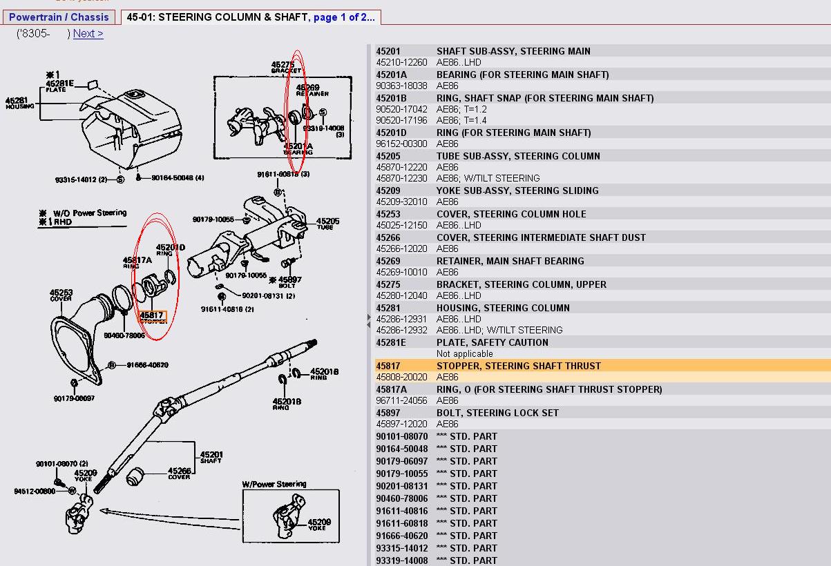

Beside this i am not sure if it completely solve my issue i think i must look in the steering column shaft and replace the bearing and stopper i marked on pics what i mean. I think it will be the stopper that was causing all the trouble. This part is not cheap too 100 euros and the upper bearing 12 euros.

Bearings for steering rack arrived but i was a little bit dissapointed because the lower bearing that i tought is bad is OK so that was a total miss and loss the lower bearing cost 95 euros at final price. So you better check if it is really OK because lower and upper bearing have always some play on the inside they are somehow not tipical bearings. So if you check the play is about 1-2 mm i have not read any ionformaion on this so this is bad that it is not mentioned in the AE86 manual.
Ok in my case upper bearing was a lot more loose than 2mm so i better to replace it and we can start with adjusting Smile
