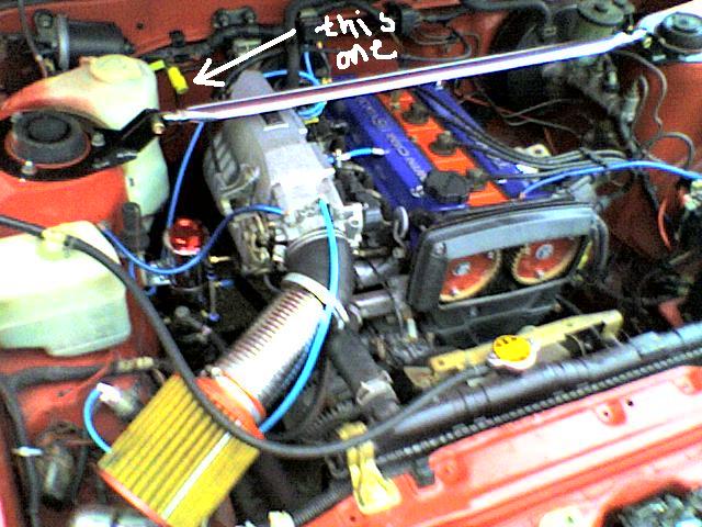

Can anybody post pic of the yellow plug connector, please ?
In the manual on the pic the yellow plug connector is square, but all I have are round yellow connectors (about 3 of them). Toyota scrap yard car park = AE92GTi - AE82GT - KE30 - KP62 |
03-31-2007, 08:25 PM
stock ignition timingq
It has a black rubber cap on it ... mine is missing in the photo...
AE86 FANATIC!!! |
04-01-2007, 01:16 PM
alimonos Wrote:It has a black rubber cap on it ... mine is missing in the photo... Tnx :wink: now I know which one it is. Toyota scrap yard car park = AE92GTi - AE82GT - KE30 - KP62 |
