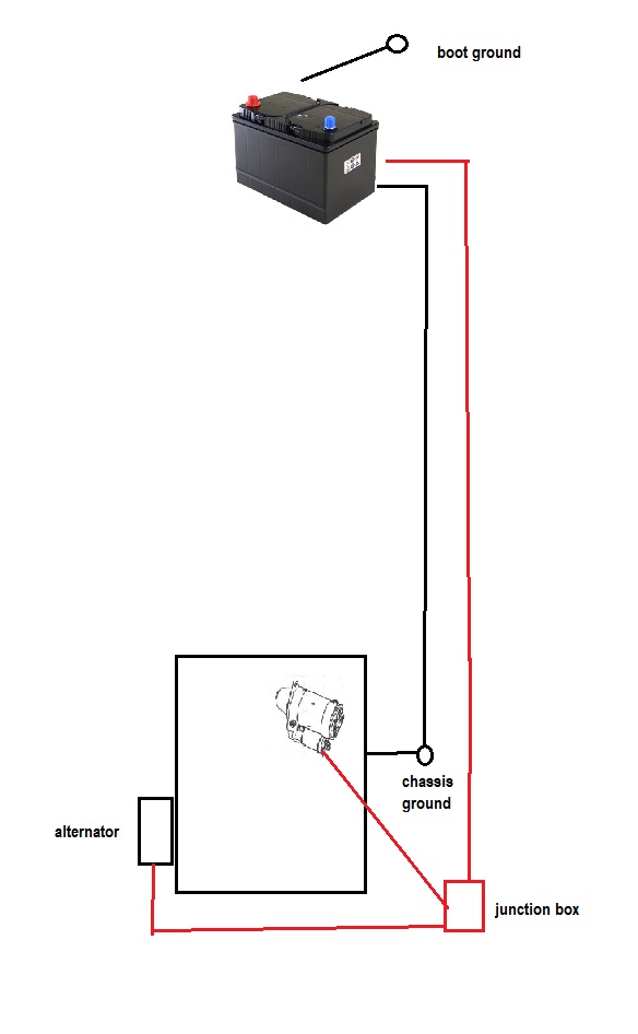

12-10-2013, 09:51 PM
starting/electrical issues
Right, you can all look at my car schematic prowess and admire the quality of my work Tongue
This gives an idea as to how everything is configured right now. I believe the cable is 4 gauge (it might actually be better than that, I'll double check the diameter when I get a bit of the leftover cable in my hands).
One other idea that has crossed my mind is to run the alternator and battery directly to the starter motor and have the live feed coming off of that to the junction box, as it would mean the live feed isn't having a potential voltage drop from anything at the junction box (lights, rad fan and power steering), it would also mean the cable distance could effectively be shorter by close to a metre, as I would be bringing it in via the other hole in the bulkhead. I'll also consider another ground on the off chance that the two coming off the block just aren't good enough.
12-11-2013, 03:29 AM
To be fair, throwing bigger cable at it is not the best way to solve this
problem. The important thing is the total resistance for the circuits...
battery positive to starter, and engine block to battery negative. That
plus the cranking amps will determine the voltage drop while cranking.
As you have stated, there are plenty of 4Ga installs that work fine. So
if your starter is in good condition and your battery is fully charged,
check the voltage at the starter while cranking. If you have 10V or
better, the 4Ga is not the problem.
Then you need to check that you are getting a full 12V at the COR
while cranking. If there is a bad (high resistance) connection on the
keyswitch power supply, or a high resistance ground, the voltage may
drop low enough during cranking to prevent starting.
Cheers... jondee86
