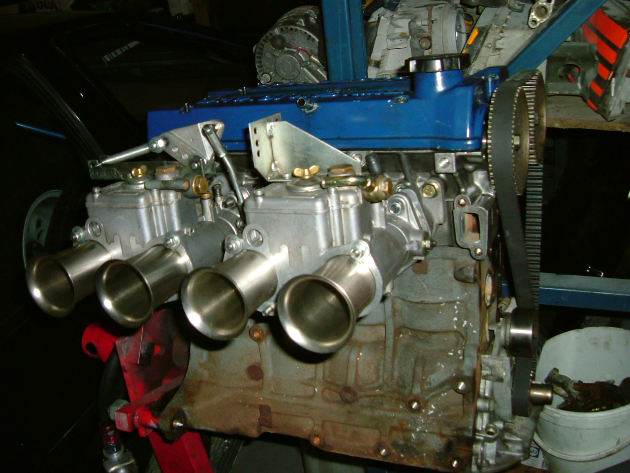

some engine pics(i must still get my fenders,hood and doors back from the painter Angry ,waiting 2 months now!)

Check the #4 cylinder fitment (right strut top proximity).

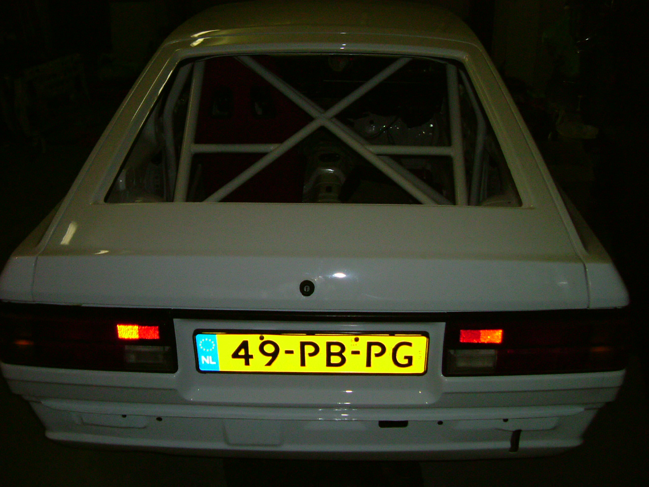

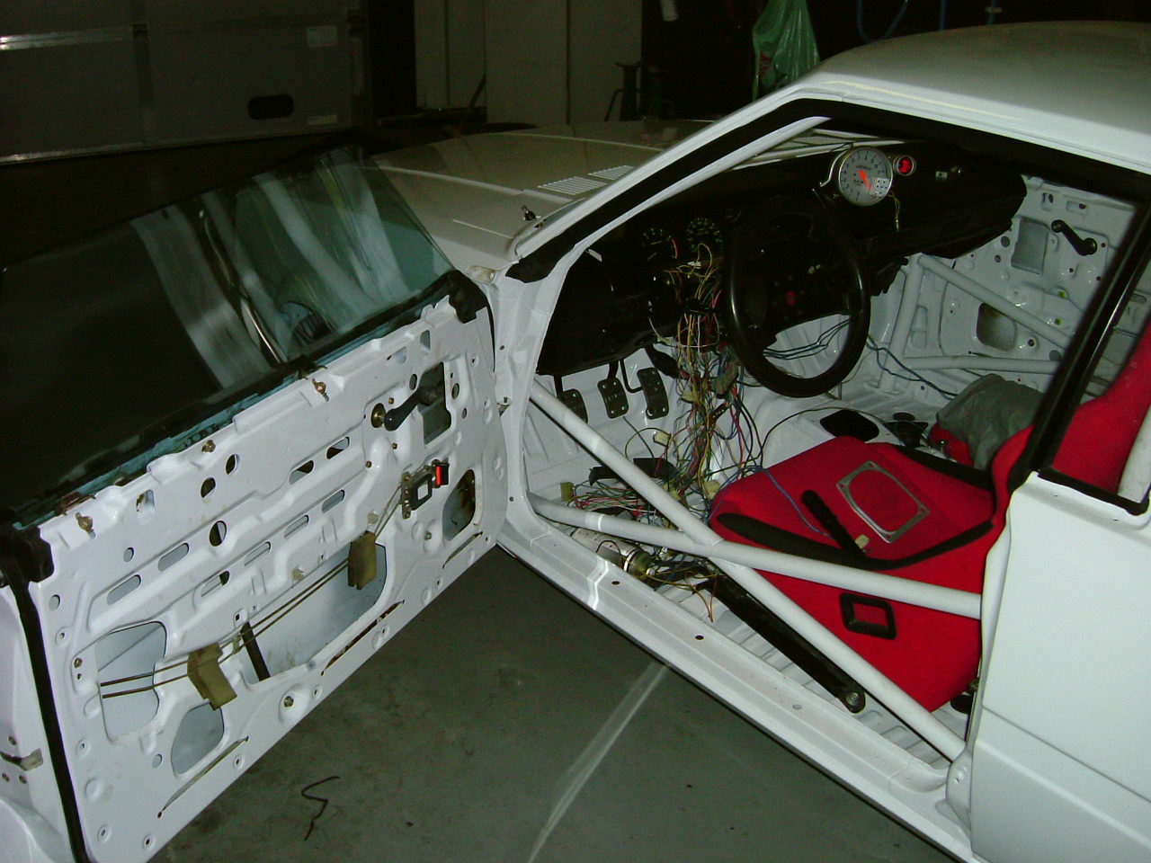

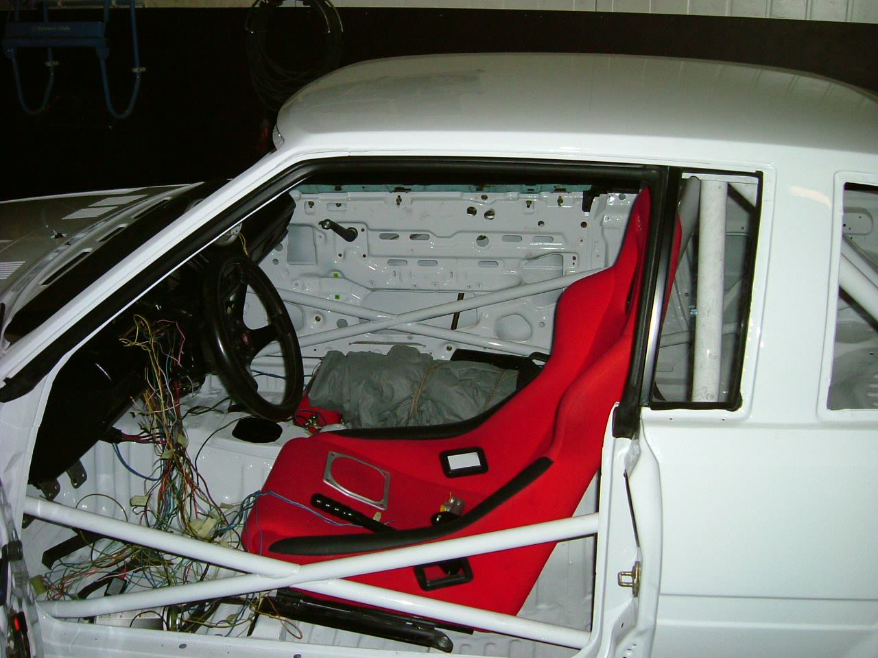

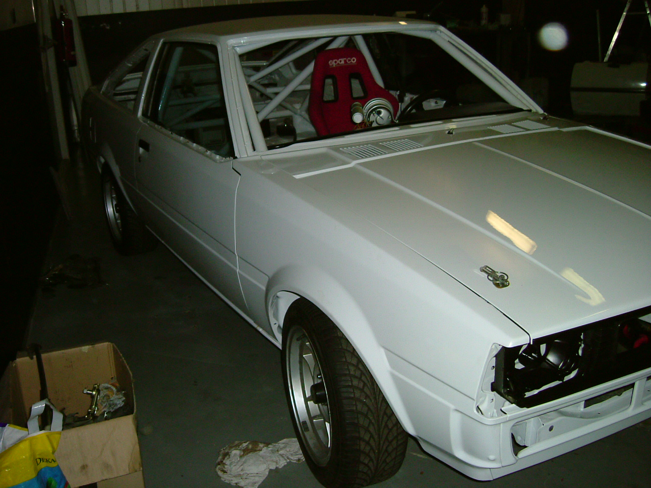

so,finally started to build the damn thing up Tongue
today i did the doors(tectyl,windows etc) and the front fenders and the trunk and some other things
next thing to do is to make the complete! wiring all new,because all i need are the lights,wiper,and heater,and all the other stuff had to go,so than you can better made a new wiringloom
the engine is gonne have his own wiring(dont know wat engine i will put in,blacktop is in my ae86 right now Evil ,and i am building a 7AGE now,but i want another blacktop) :wink: must find out if the 7AGE is good
for drifting
my new fuelcell will come this weekend and that must fit in the place of the spare wheel(8 gallon)
no more fueltank under the car Hurray!
here are some pics,enjoy

jamiemirror Wrote:Check the #4 cylinder fitment (right strut top proximity).
explain please Smile
03-11-2006, 12:35 AM
Post: #108
project TE71 IT'S ALIVE!!
I noticed that when using sidedraughts on AE86 4AGE, the right strut top mount is very close to the trumpets of rear carburator (esp. section serving cylinder #4). That way when I tried to make my intake adapter plate, I used only 35mm thick plate. That way I can vary with shorter and longer trumpets because I have more room for carburators and trumpets - and no risk that trumpet will touch the strut top mount. You can just check how long trumpets will fit (the problem occurs only at cylinder #4 area).

Jasper,
Another car without a passenger seat? Dont you ever learnWink
03-11-2006, 10:33 AM
Post: #110
Mux213 Wrote:Jasper,
dont worry mux,i have two seats Tongue
