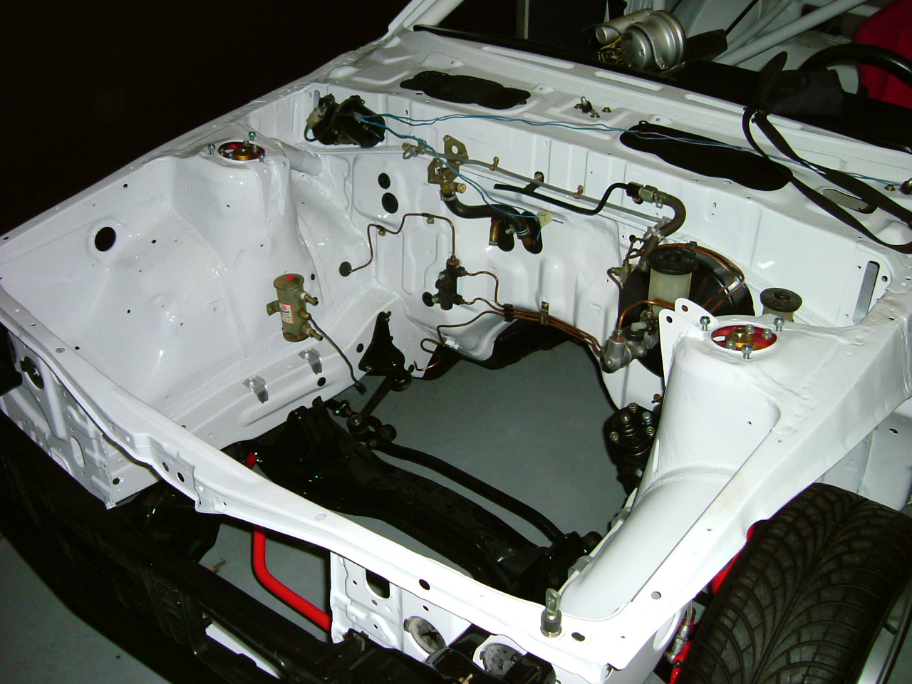

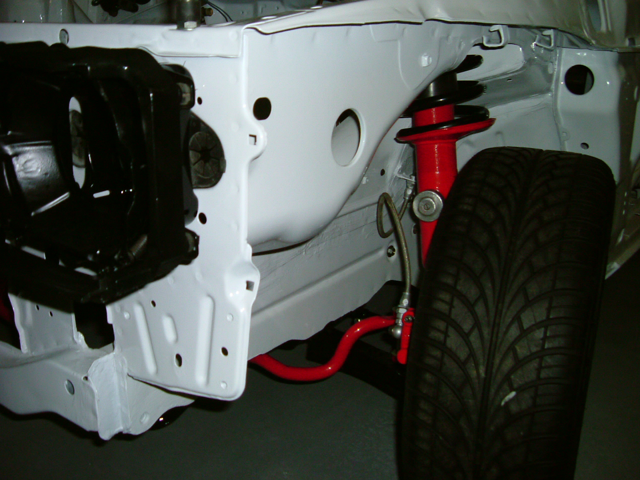

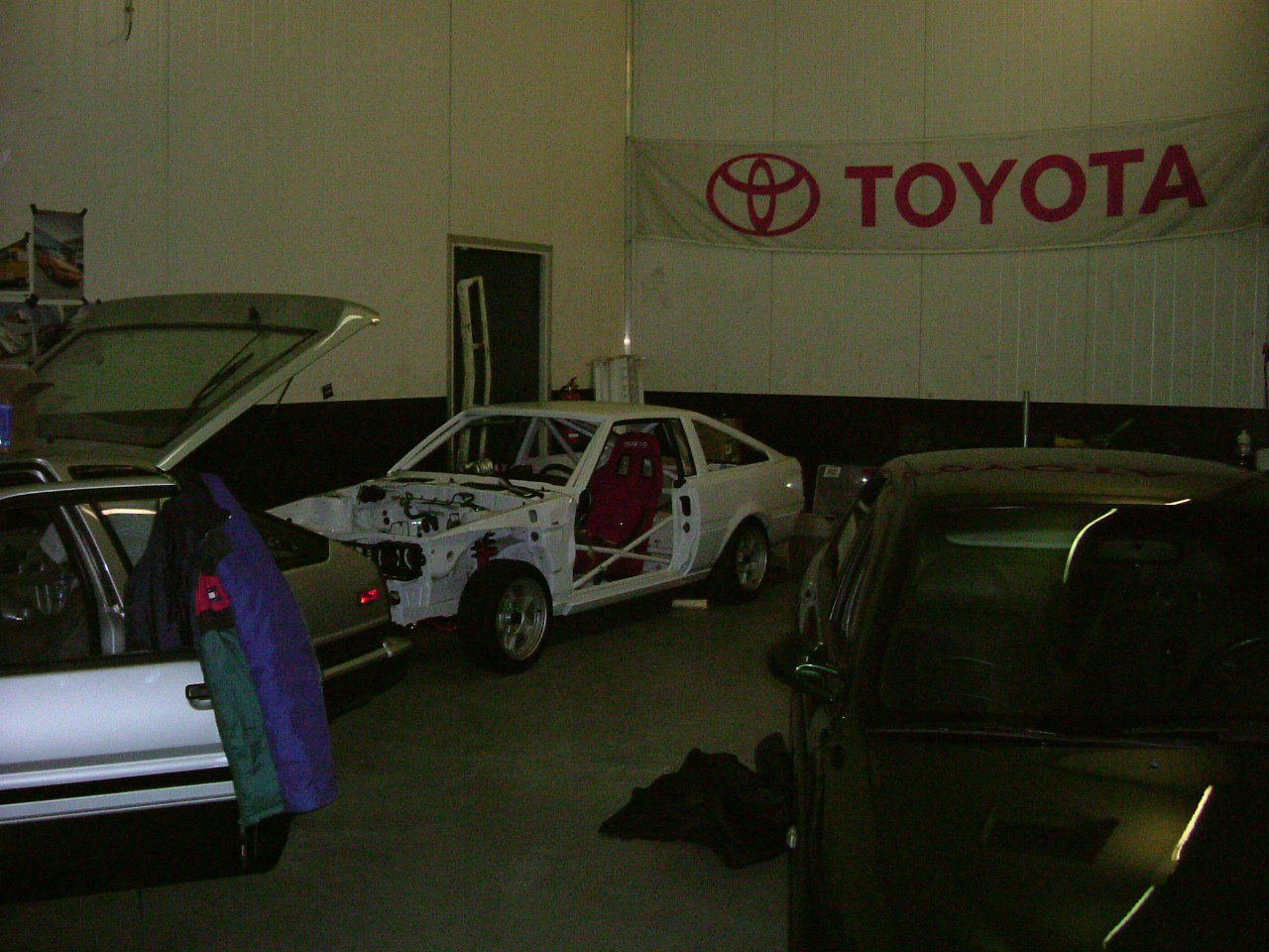

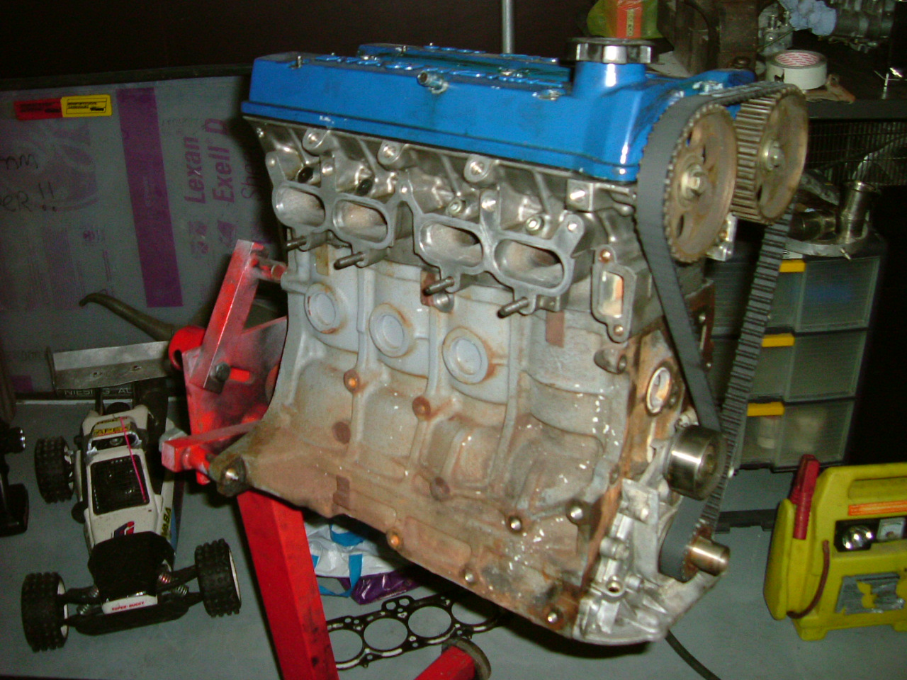

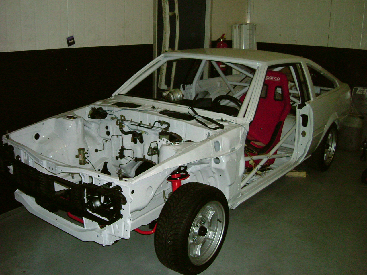

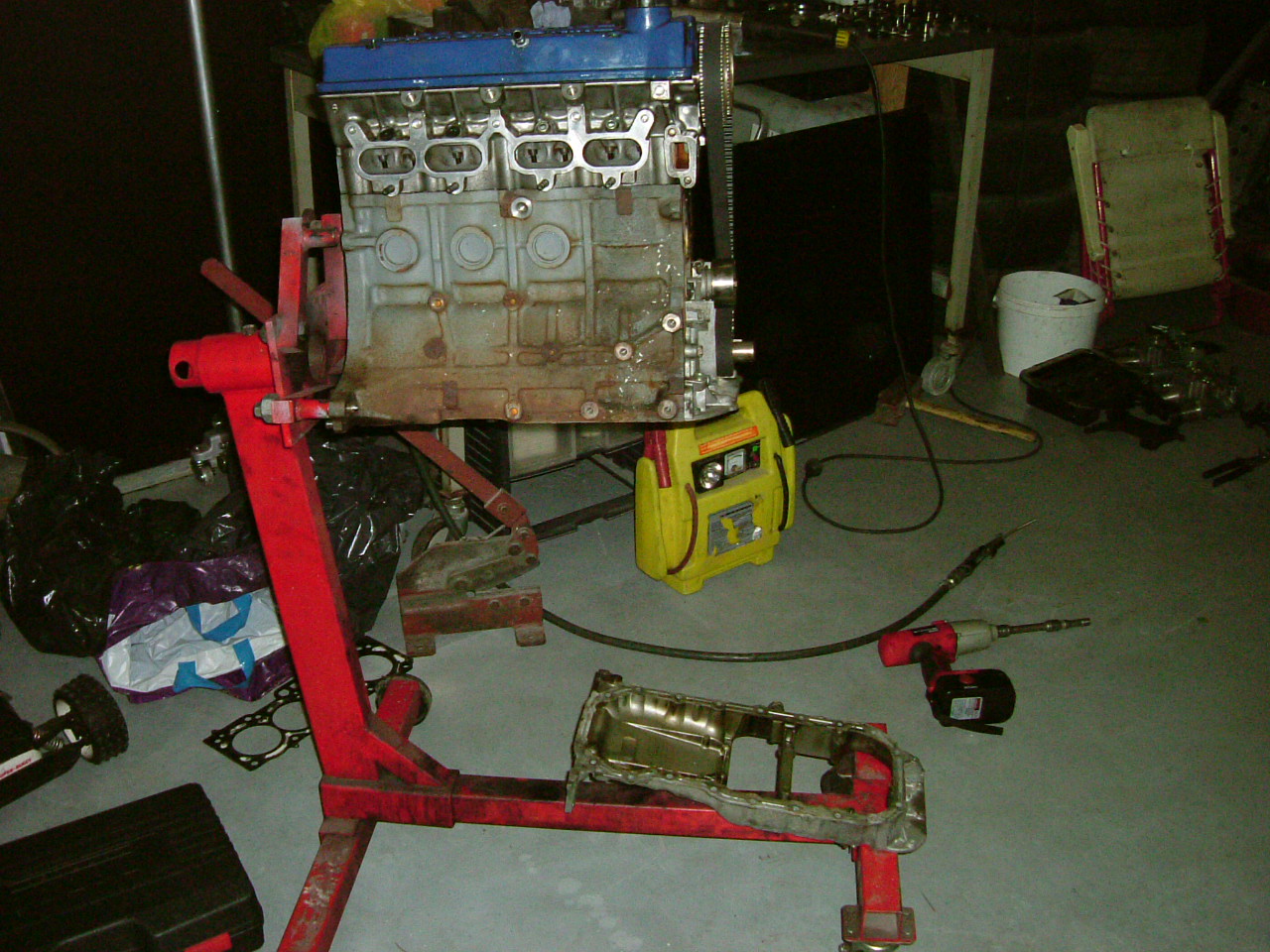

little update of the te71 and some pics of the 7age(just checking some things for fitting (i must tune it up,gonna rebuild it completely ,new pistons and bearings ,full balans the crankshaft etc)
i hope i get my parts back from the painter this weekend ,so i can finish the body an can spend all my time at the engine ![]() next week my engine gonne be completely rebuilt with (4age ae92 20mm piston pen)wiseco hi-comp pistons,carillo rods,arp bolts for rods and head,and stronger rod bearings,and fully balanced crank. so i hope that 9000 rpm is not longer a problem for my 7age can't wait to take it out for a spin
02-09-2006, 10:43 PM
Post: #97
project TE71 IT'S ALIVE!!
You really cleaned out the place.
So much space after you removed the bridge.
