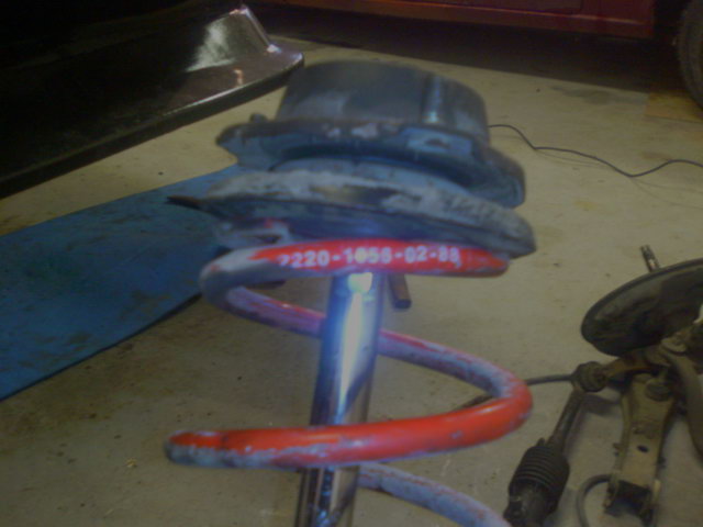

I bought these front legs from P-Nut lately.
[Image: AEU86 AE86 - non progressive, red spring... any idea?]
It has got red, non progressive springs on it.
Anyone got an idea which brand and how many they lower the car?
Since red isn't a std. Toyota color i'm sure they must be lowering springs.
Today i found out that KE20 springs have the same diameter as the AE86 ones, so i'm gonna try to lower my car with these springs first (i want to get rid of some bodyroll when i go try to drift my car the 18th of februari on a driftschool event Big Grin).
I really want to put these front legs as a complete set in my car, but that's to much work (refurbish brakes, fit AE86 brake cylinder + booster, make new brake lines etc. etc. etc.), but since the springs are the same, this is temporary.
Anyone got an idea?

Eibach?

is there a partnumber on the springs? if there is i can find it out here at my business.

it says 2220-1056 (but i needed both springs to find the complete number, because they have some rust Tongue)

Maybe they are Koni springs...those are red as well, and you see those around more often than eibach springs. While your at it I would also take som etime to inspect what kind of shocks are in there. the nut that holds the shock in would probably be round instead of a hexagon if it has koni's.

Well, you have to consider the fact that the stabilisers on your car are probably not very impressive either. And if those shocks in the ae86 struts are worn out it will still ride like crap regardless of the springs.
Get some koni's, or if your budget is in the gutter find some tokico HP or KYB GR-2 shocks.

I have same springs. My were with koni's inside. 2 bad my spings were cut before so car sits very very low.
02-14-2006, 10:35 AM
non progressive, red springs. Anyone any idea?
Oh, and I also had set of yellow springs with koni shocks.
IMO red = eibach, yellow = koni.
Yellow springs were almost stock height, but bit stiffer then stock = good for snow. They have writen on them 222C-1113.
