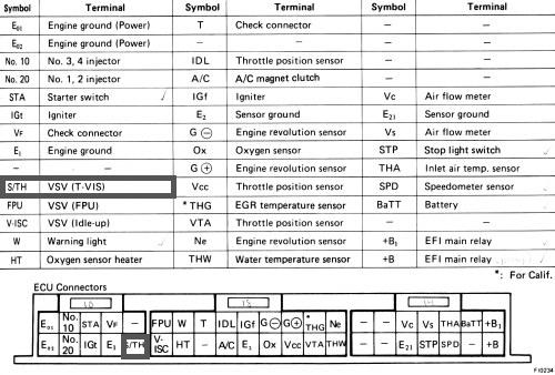

Today, I figure out that my tvis doesn't work. There is no vacuum in low rpm, and the butterflies are opened all the time. I disconnected the plug from VSV and check with voltmeter. One wire has 12,6V if connected with ground but the other wire is dead (no ground contact aether). Any suggestion? What should be on the other wire?

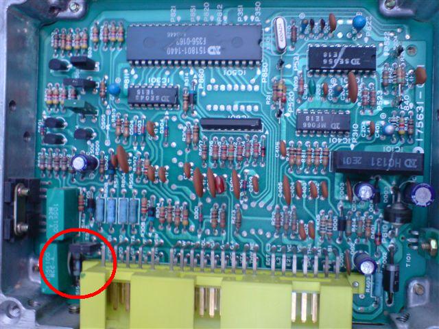

The other (dead) wire is connected directly to ECU. So there are two possibilities:
1) The wire has been interrupted somewhere
2) The ECU doesn’t provide ground
It seems I have the ECU problem. The wire to TVIS VSV is OK. ECU doesn't provide ground contact after ignition key has been turned on.

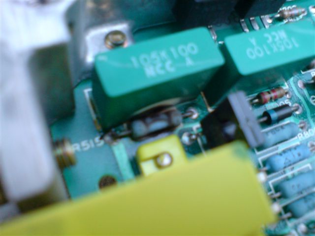

I found the resistor R515 has been fired up and totally dead (no continuity). I will try to replace it and check the TVIS pin again.

Auch. Good find. Smile

good find Smile
but there must be a reason why it's fired up.. ?
