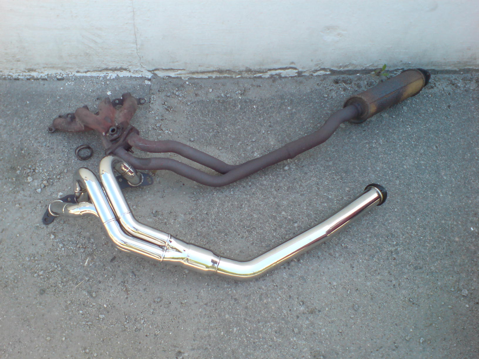

which models are compatible with western cars...?
I got an rs*r steel header but needs some modifications, like a flange to separate it from the steering rod. So, when I understand which one fits right away I will buy it and sell the rs*r
pics:
http://img340.imageshack.us/img340/1081/cimg6611hm6.jpg
http://img381.imageshack.us/img381/406/cimg6612xf9.jpg

I'm not sure if HKS had different variations, but my friend got one and it didn't fit, the pipe went straight through where the steering column is.
