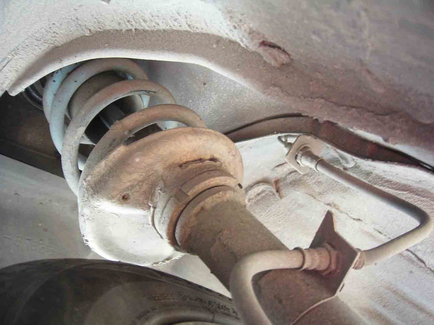

Finally raised the car to check suspension.
Kyabas white are at the rear with unknown springs (eibach i think)
and YES i have adjustable front suspension with unknows spring (TRD i think) and custom made Konis.
Strut has a welded perch on it so you can adjust high

AArghhh...just looking at that panhard rod bushing hurts! Confused Interesting suspension setup...never seen that before..original idea. Probably necessary with those (trd?) springs on it.

Yeah that bushing is to laught at... Big Grin Big Grin Big Grin
It's a shock to see them like that...
What setup Ivan? The front one? TRD springs and like that greenish/blueish color, right?
A coil is welded at the outside of the strut (no cutting,no short stroke of course) and the stock "saucer" is also welded in to a rotating perch, so all that thing rotates and you ca adjust ride-hight.
I guess now it's at the lower point Evil
