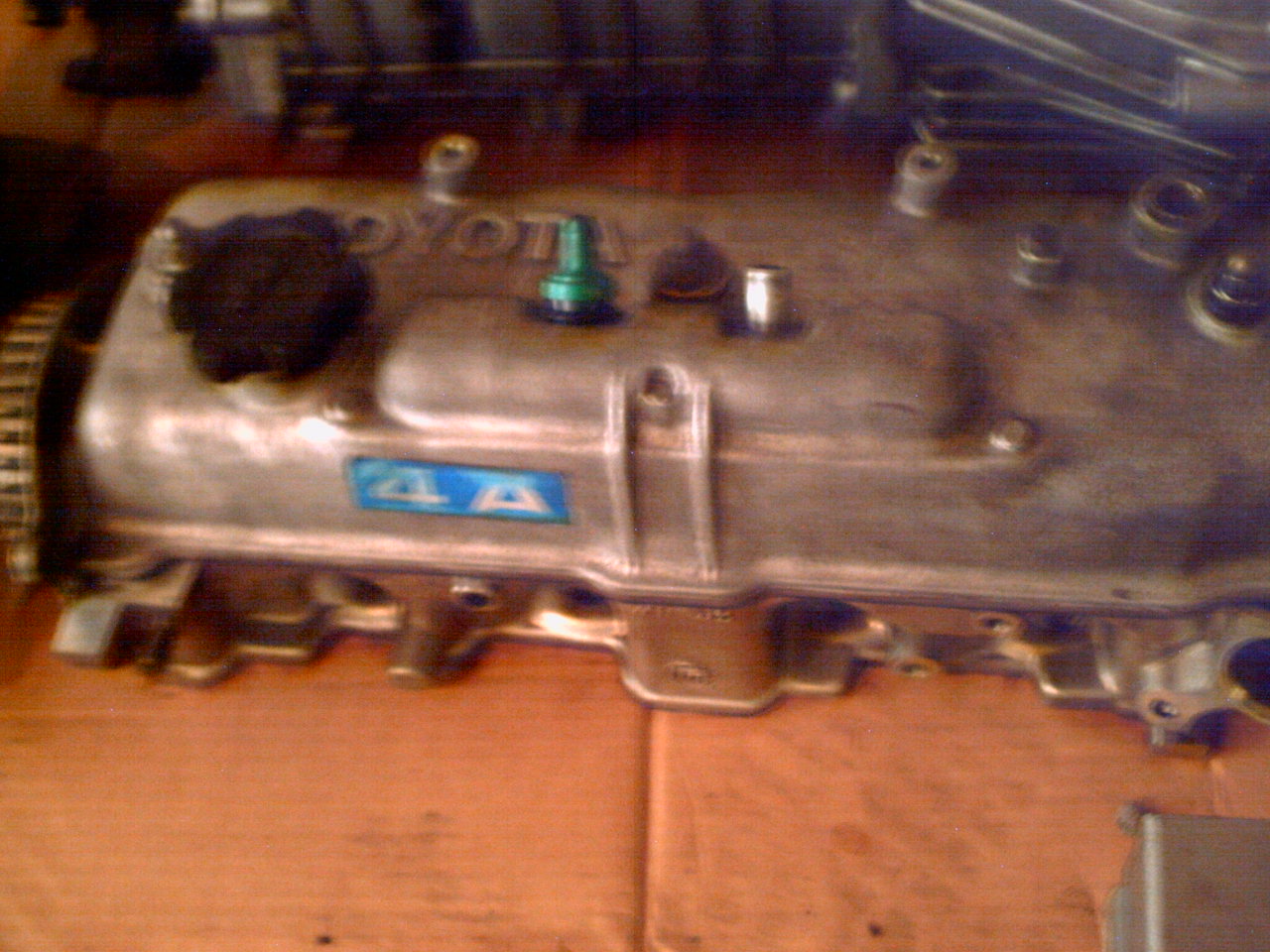

from which block is this head
03-26-2007, 08:27 AM
from which block is this head[/code]
03-26-2007, 08:37 AM
Looks to me like a 4AC head, but there are probably a lot i could mistake for it =/
03-26-2007, 04:08 PM
It's 4AC head (1.6 SOHC ~85 HP)
I have one around somewhere Smile

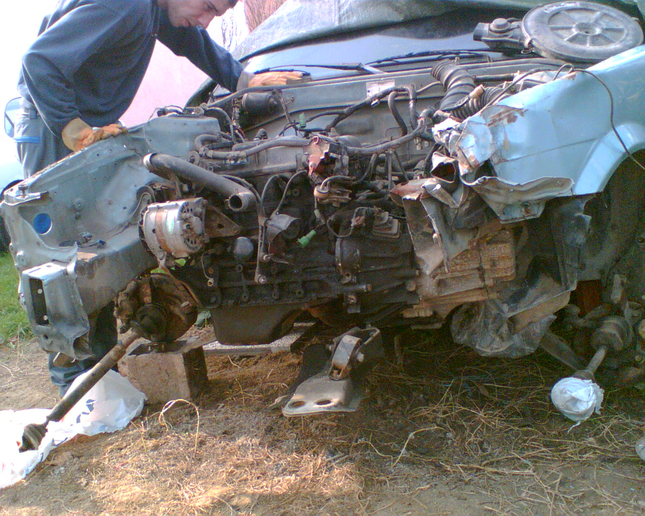

wow....what happen there
dont you or any 1 have a picture ot a 4AC block ......from the top and side
03-26-2007, 04:37 PM
Max_toy Wrote:wow....what happen there
It's my parts car.. I bought it crashed.
