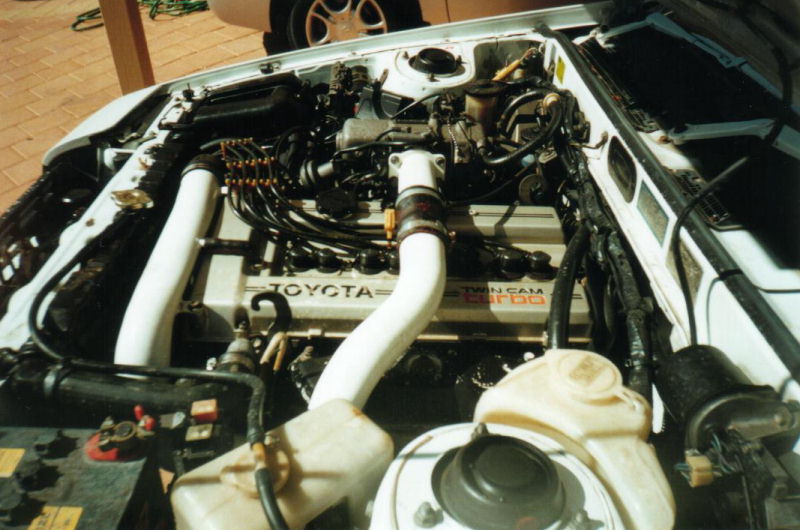

bigger engine??
http://members.fortunecity.com/daytona/a...ueno06.jpg
Copy paste in adress bar...
Pic of 3T-GTEU engine

bigger engine??
Too bad that they are mega rare..quite nice design. Twincam head with a 40degree included valve angle, but the oldscool metal lump of on engine underneath..That means that they will accept crazy amounts of boost without flexing etc..one of the most popular drag engines in the world.
3S-GTE would be a better choice ofr driveability, fuel consumption etc.

bigger engine??
Speedline Wrote:http://members.fortunecity.com/daytona/a...ueno06.jpg
And added as attachment. We wouldn't loose such a beauty. Wink
