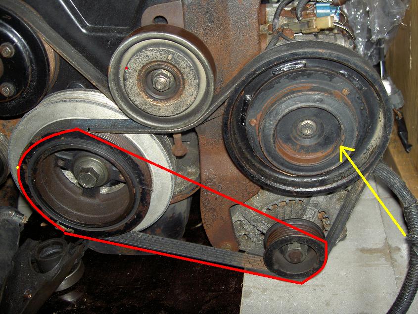

Is there a way to get rid of the "pump"(with yellow arrow) so that i can use a belt like the red line??

Remove the power steering, i guess...loop the lines or install a regular steering rack, then find yourself a belt of the correct dimensions.
By the way, what's your alternator doing down there? Making room for the supercharger?

yup its a supercharger engine :wink:
I'm just searching for a shorter belt

is the alternator adjustable in the sense that it sits on a pivot bolt at the bottom and then has a second bolt up top that slides on a slotted bracket?

No the alternator is not adjustable on the bracket but i was thinking to make new bracket like on the 4age but then for the other side of the engine

looking at the size of the ps pump/alt bracket, would it be feasible to tap into it for 1/2 bolts to mount an upper slide bracket say from a 4AC or 3TC motor?

yes something like the bottom pic is wath i mean :wink:

Is there anyone who knows if there's a shorter belt (+/- 5cm) then a stock 4age belt??

You should be able to get a whole variety of belts. When we rebuild something. (move stuff and such) we usually just measure up the length the belt needs to be with a cut oversized belt. And go order a new one thats exactly the same length and have correct tracks.

@gnugfur aftermarket or stock belts?
