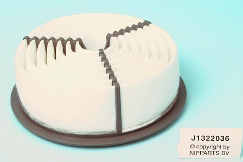

I have the same stock setup too (AFM swiss version).
I've bought my original filter at Toyota dealer, it costed me about 25-30 euro. This was two years ago, I hope it can still be ordered.
If no, try to look at Nipparts distributor, nipparts filter code J1322036 (toyota oem code: 17801-16010)
Regards
Andrej

air filter for swiss ae86 (AFM)
Bean Bandit
the one you posted is for 4age MAP version... We have swiss 4agec version.
