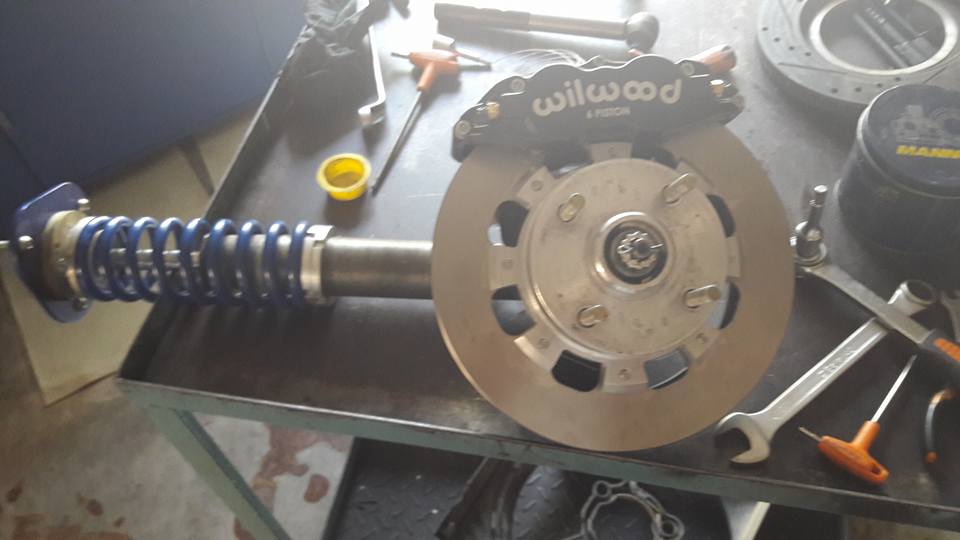

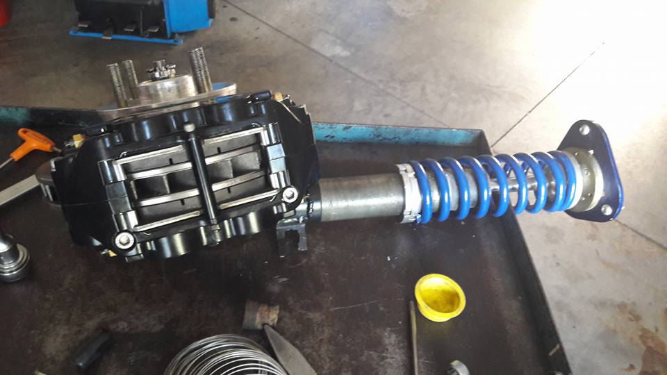

Here is my big brake upgrade that i made my self . 6pot calipers and 300x32mm discs from wilwood . i custom made the disc hats and the caliper adaptors.
and i found that i can fit also 305mm discs with the 6pot calipers and with the smaller 4pot calipers it can take up to 310mm discs to 15inch wheels.
