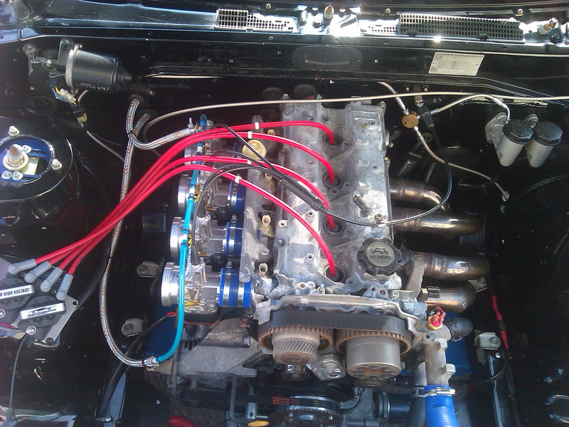

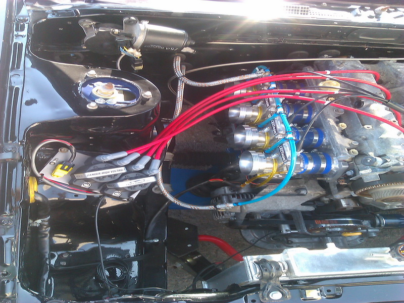

all wiring is done, carbs in place , exhaust in place , the motor is running and the car start rolling .
just fixing the brake lines and clutch line .

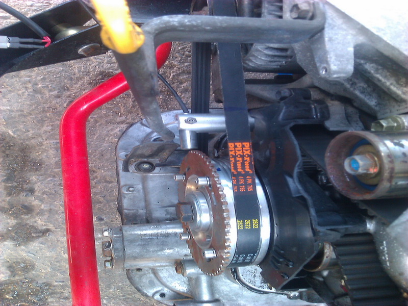

Here is the crank trigger from electromotive ignition more than 50000 volts power ,and the dificult was the exhaust to make room for the steering .

06-24-2013, 11:55 PM
Post: #84
sick engine Smile Really interested in seeing the result

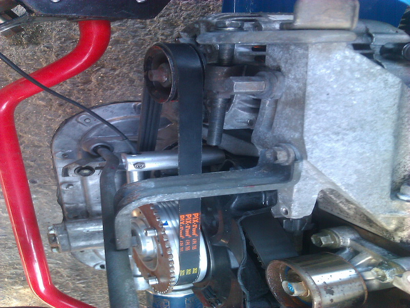

is that stock sway bar, or made to fit?
06-26-2013, 10:38 AM
Post: #87
corolla4agze Wrote:is that stock sway bar, or made to fit?
the sway bar is like stock dimensions .
Tanabe sustec.
1976 TA28 CELICA
1978 PUBLICA PICKUP
1980 4WD PICKUP
1983 AE86 LEVIN
2007 AYGO
06-26-2013, 10:39 AM
Post: #88
Its close but i think it works.. how close was the firewall and the steering rack on you?
i do have similar job, just about go cut stock engine mounts..
06-26-2013, 01:44 PM
Post: #89
corolla4agze Wrote:Its close but i think it works.. how close was the firewall and the steering rack on you?
look at this fotos http://www.aeu86.org/download/ae86/id/15070.jpg
and this http://www.aeu86.org/download/ae86/id/15069.jpg
i use the trd mounts for the altezza i cut the subframe of the 86 and bolt right on the subframe the altezza ones .
try to put the engine as low as possible and as rear possible .
steering rack i cut liltle bit the alloy at the transmission case i will try to make some fotos for you .
1976 TA28 CELICA
1978 PUBLICA PICKUP
1980 4WD PICKUP
1983 AE86 LEVIN
2007 AYGO
06-26-2013, 02:16 PM
Post: #90
i have read that is200 engine mounts are similar but harder.. those not cost lot.
idid drop front axle about 8mm (weld spasers between body/axle)so little more room there aswell.. in weekend i hope i get to put engine on.
