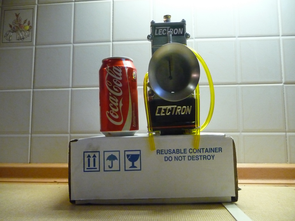

hi dear friend .
first this carbs are not from stone age .
check all drag motorcycles they are usin these carbs also the top fuel bikes .
also the m1 yamaha was racing with carbs and was makin more power than the ecu after just the fuel consumption was to hi .
with good carbs and good ajusment you make same power or even more .
motorcycle technology is far more advanced than the cars .
did you ever try fcr carbs to fit in the 1,6 engines .
take a look at the japanese almost all of them use fcr carbs they are 41mm
and they open them at 43mm. drive first a car with proper carbs and after tell me about it .
a friend of mine put the lectron carbs in a honda civic bore to 1900cc and produce 338bhp .
with stone age carbs????

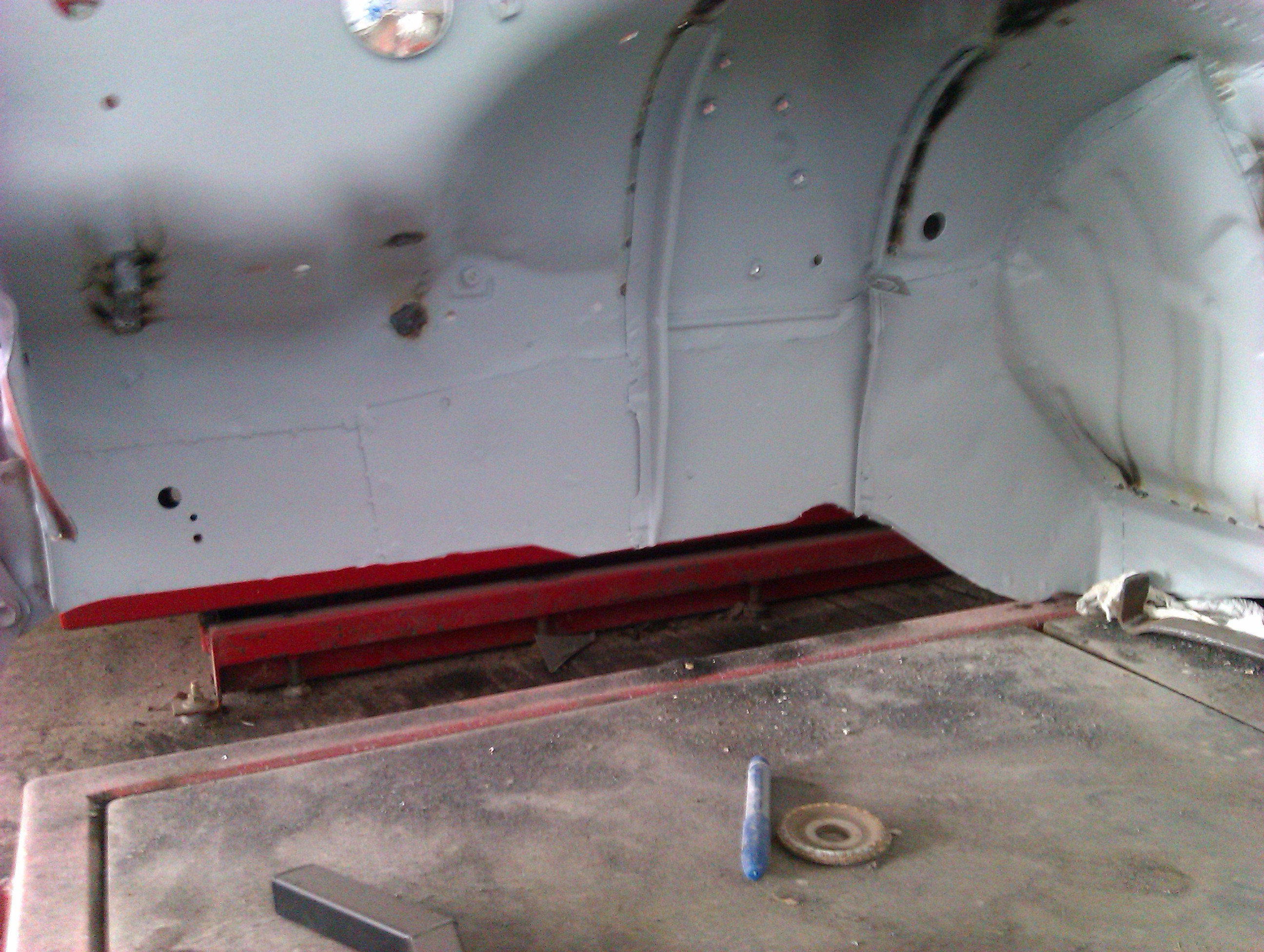

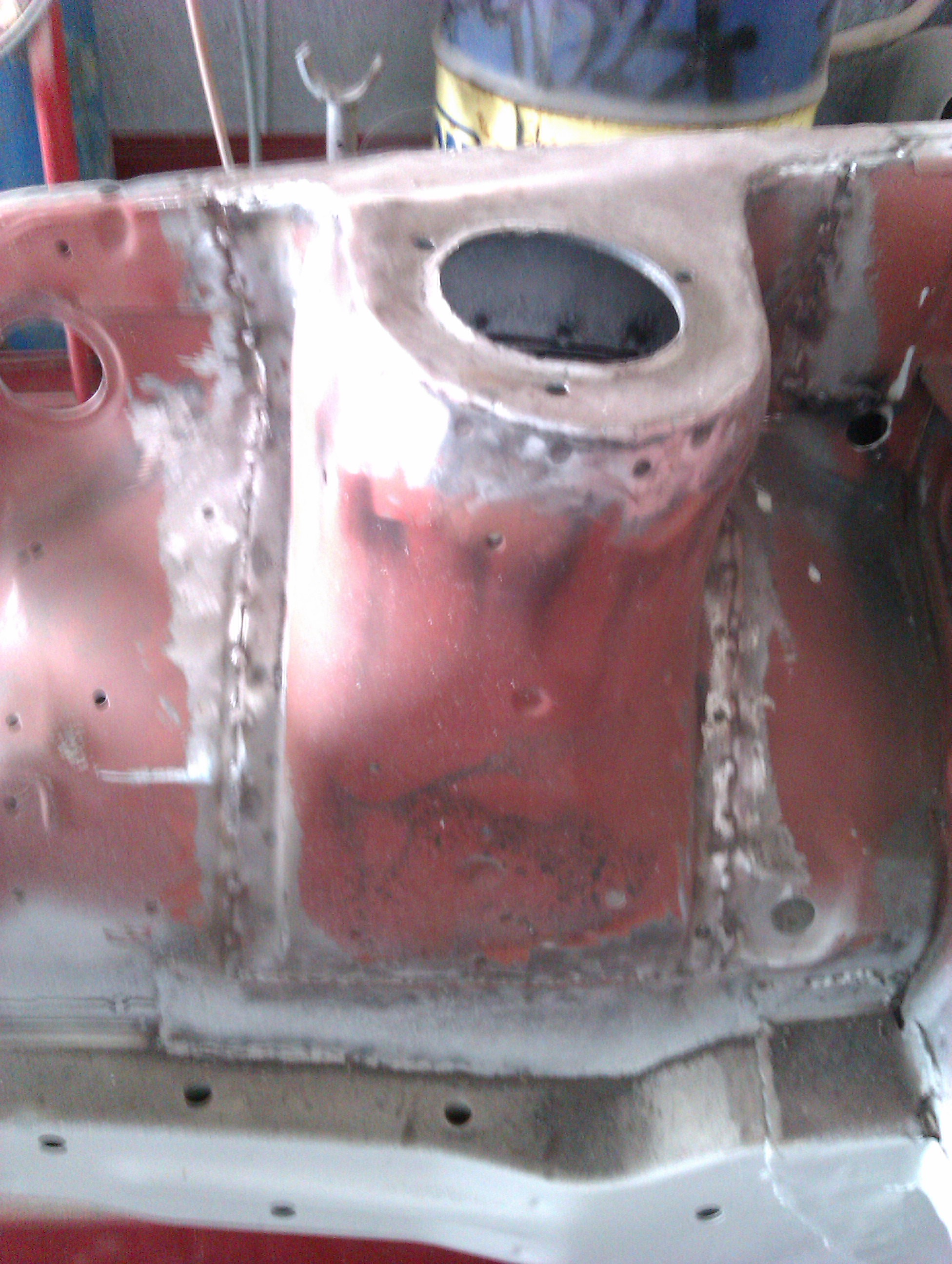

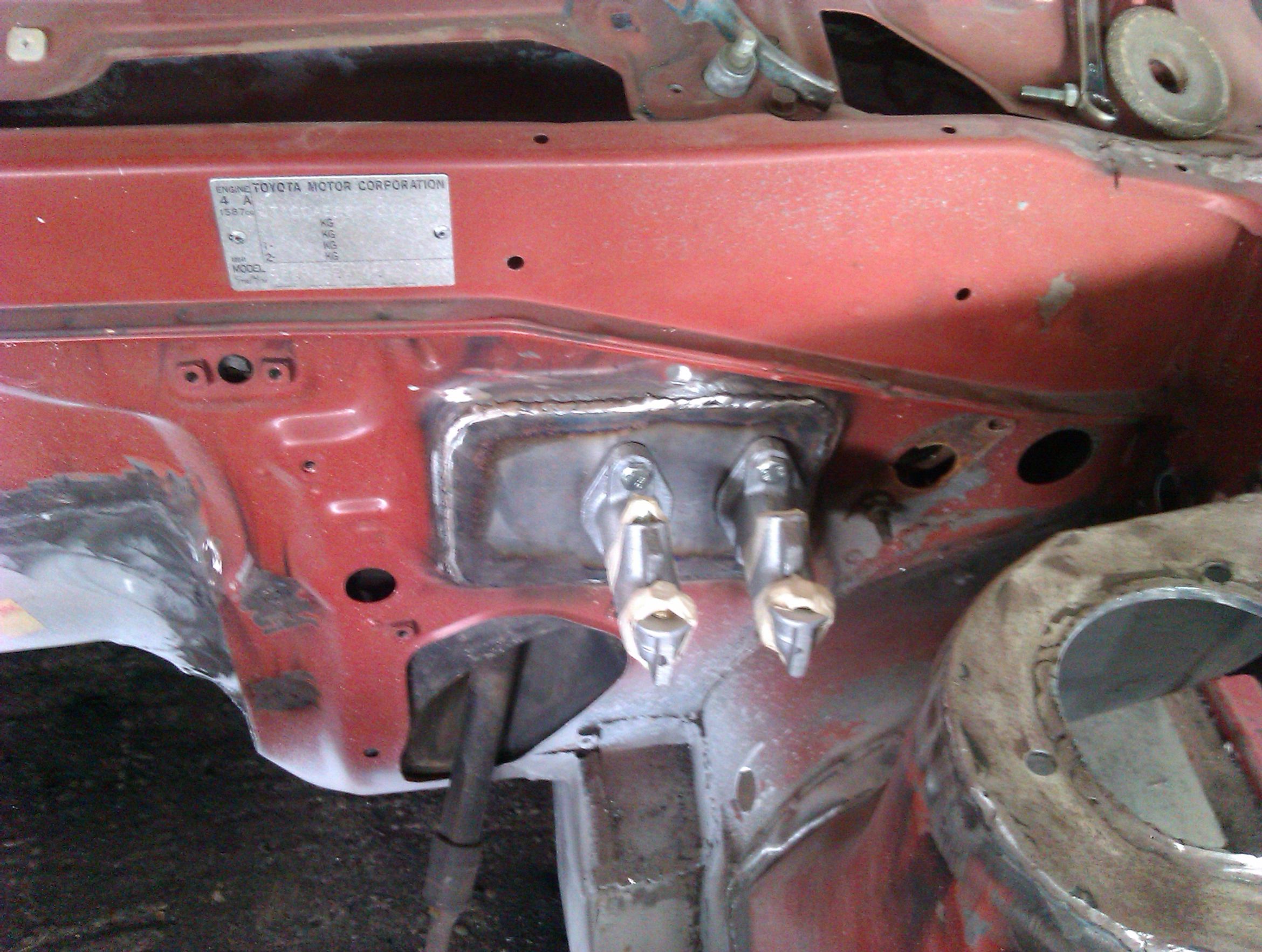

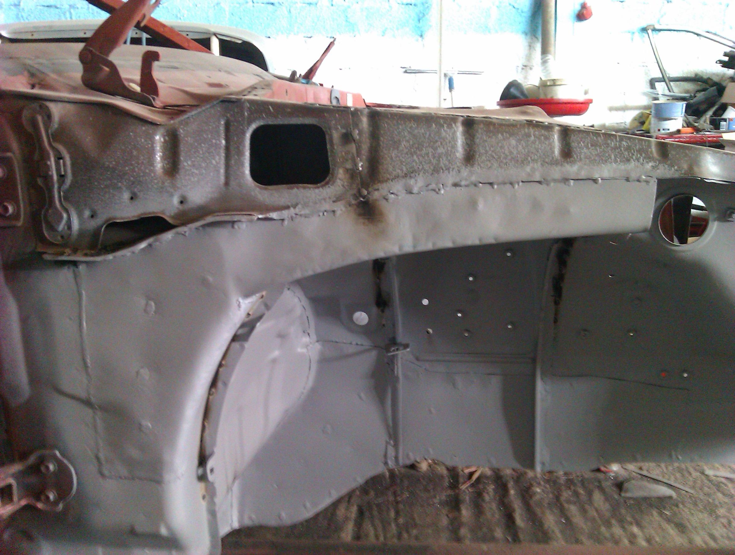

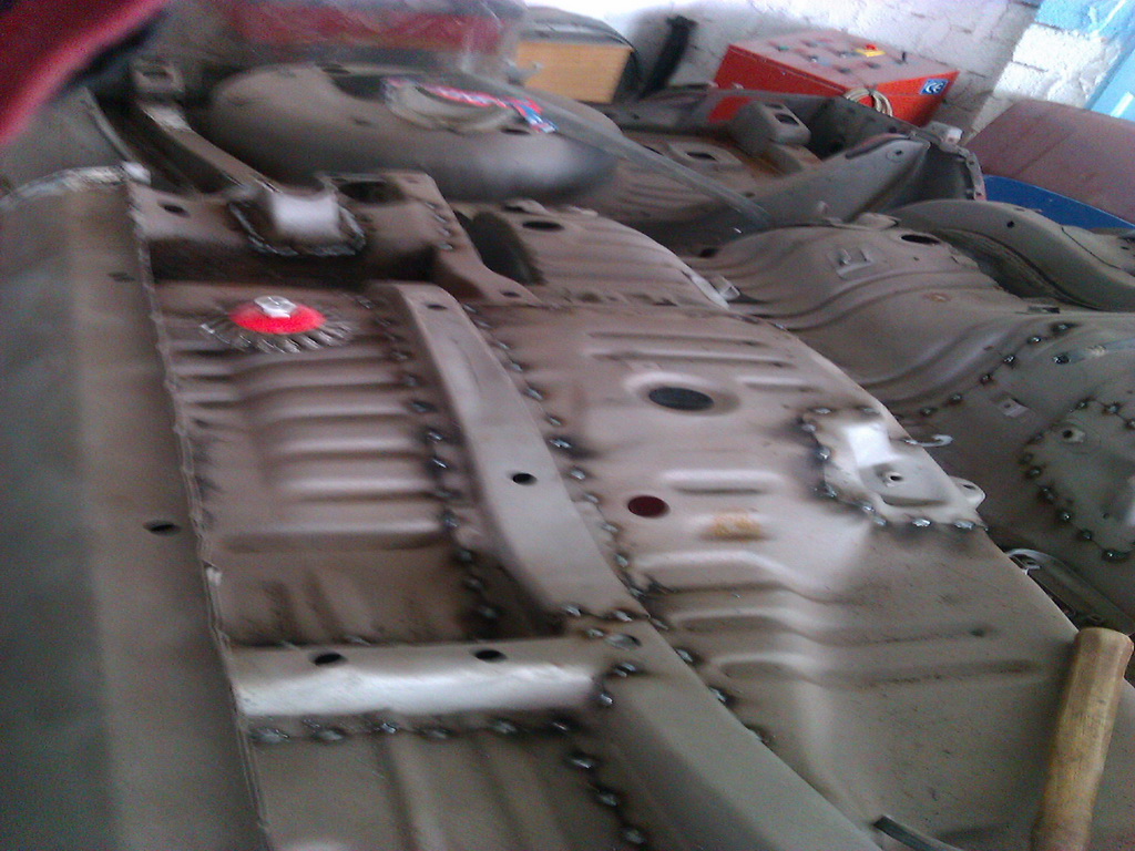

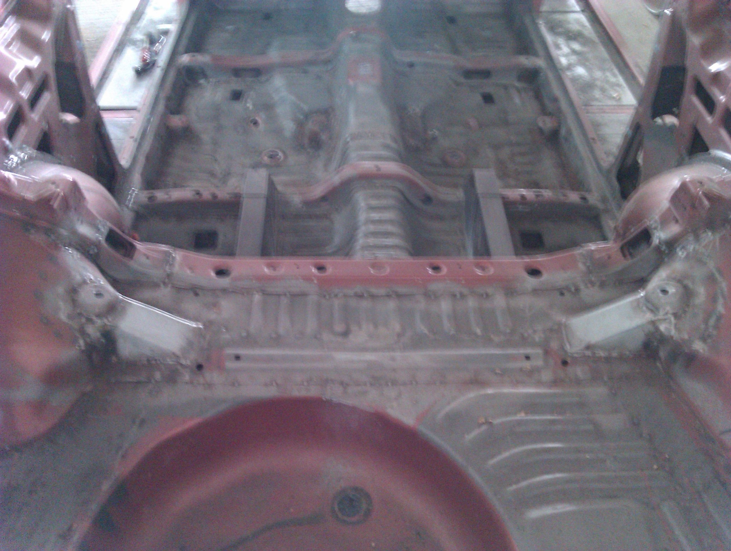

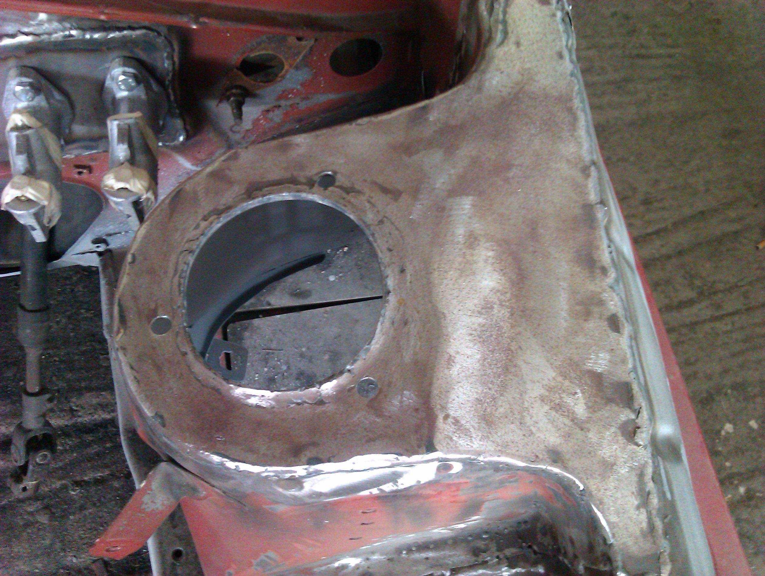

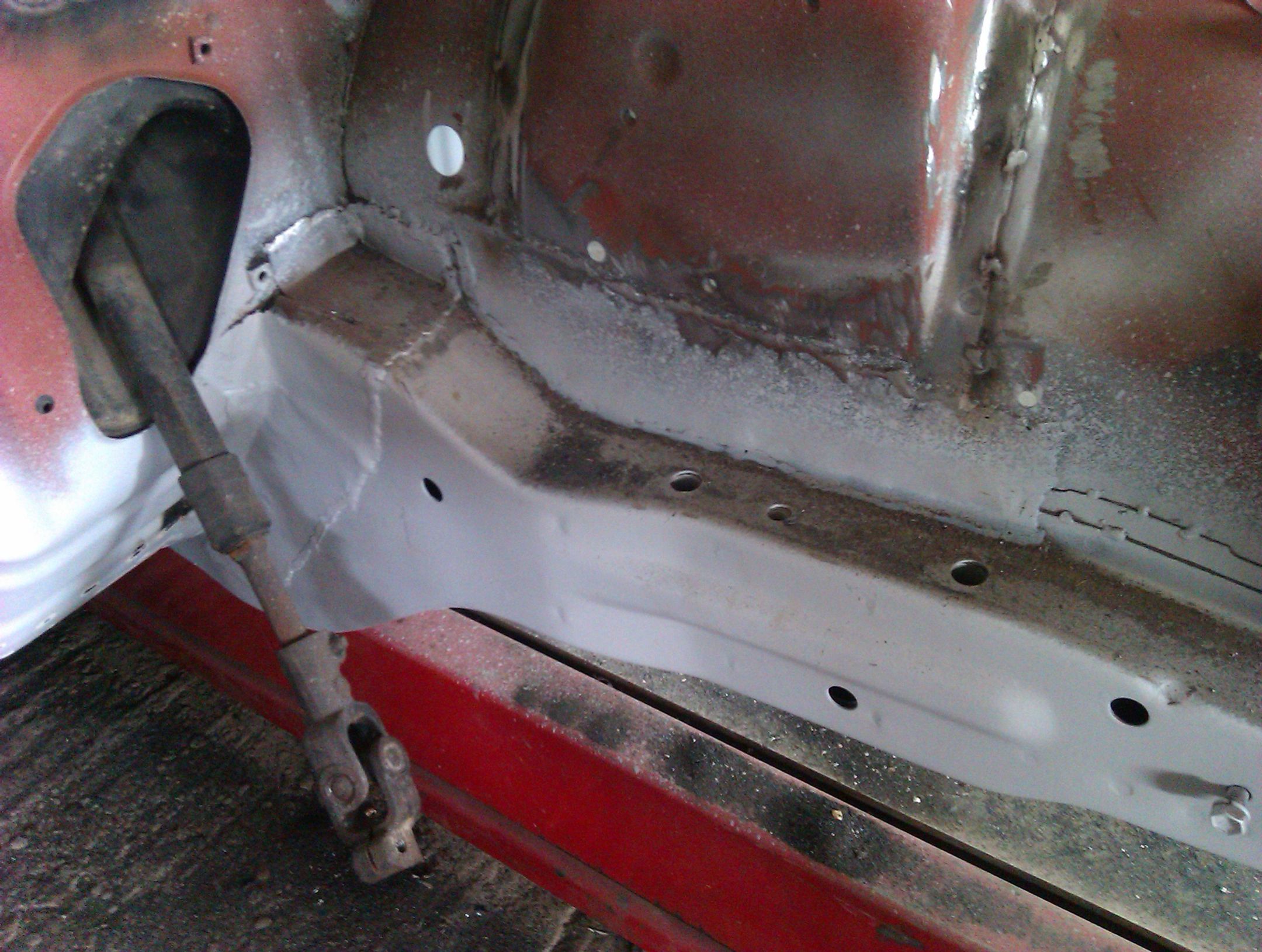

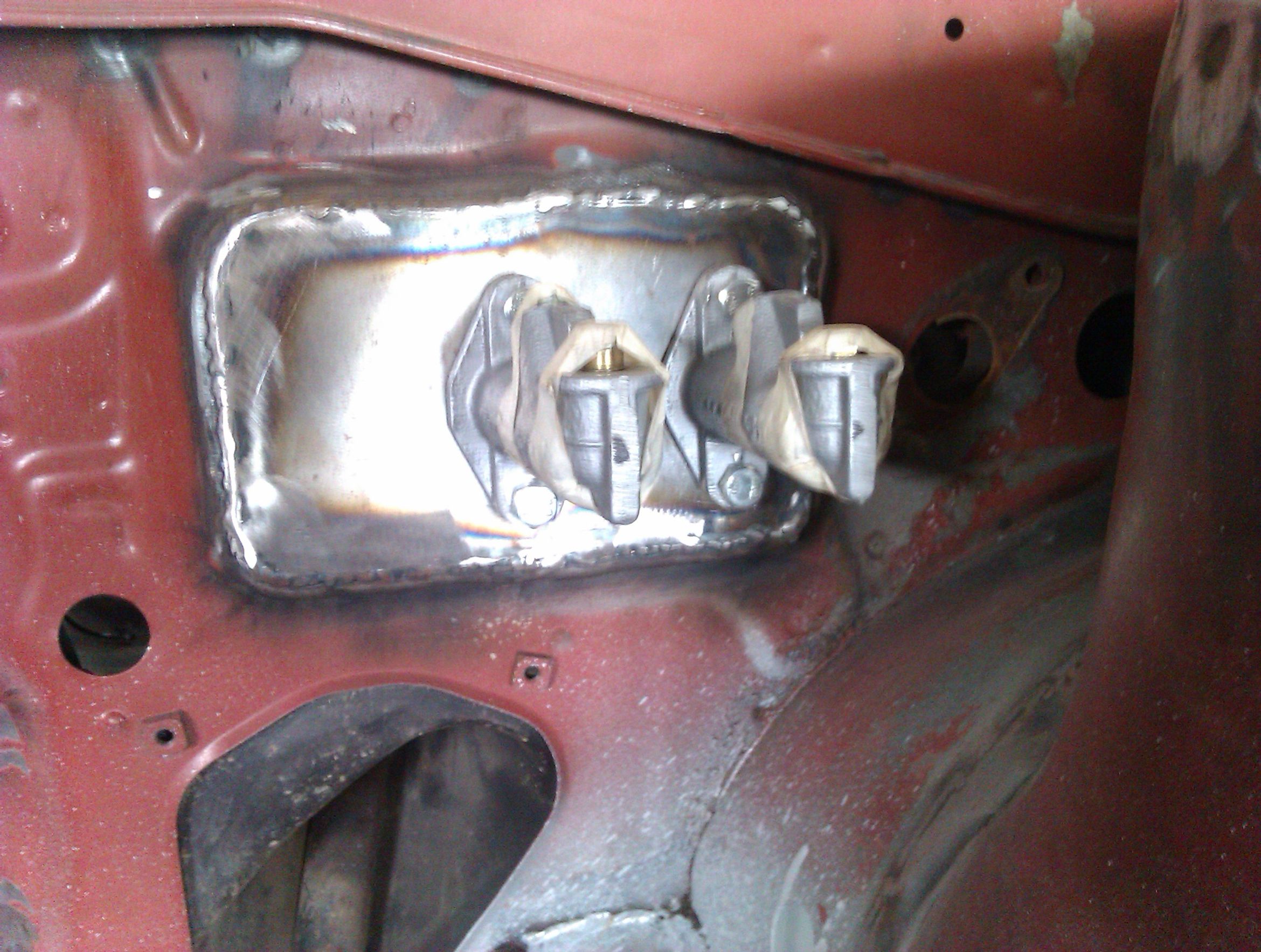

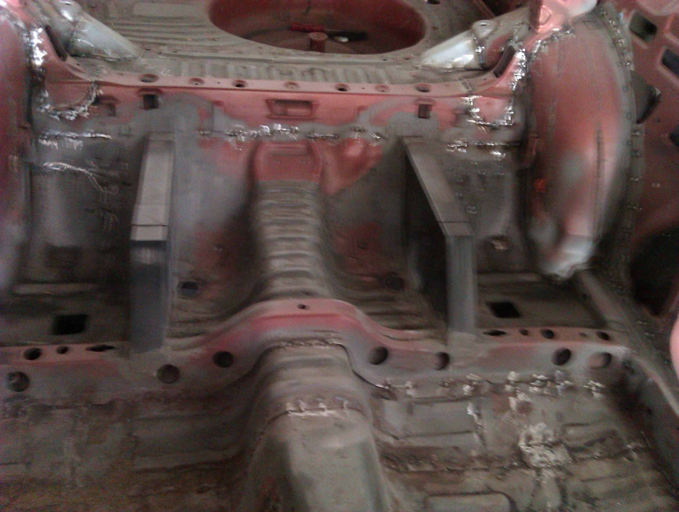

car return from sand blust and start the welding.

Good work in the welding..

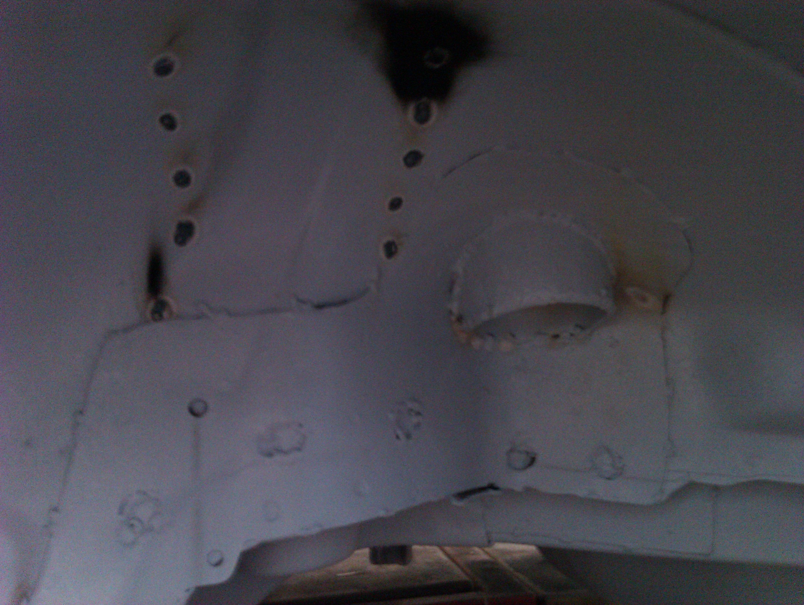

next week comin the roll cage .
more fotos in couple weeks .
