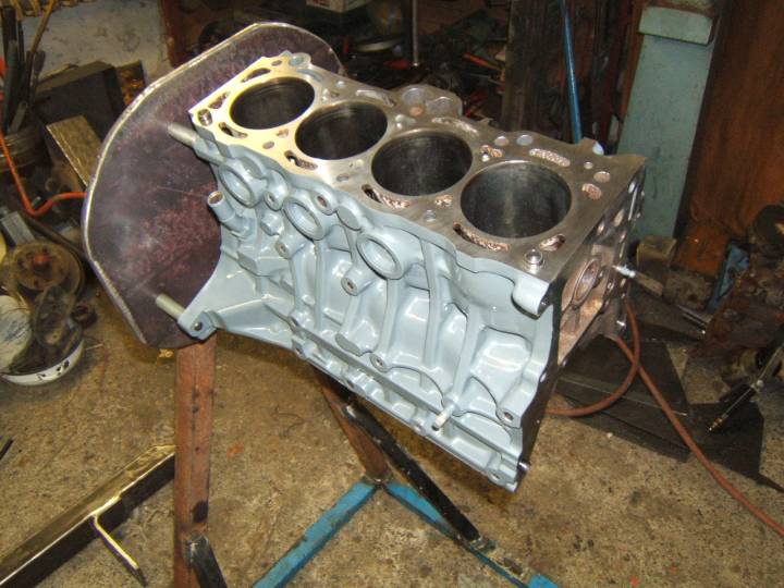

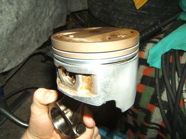

ZDoman,
Be carefull mate, that's how we destroyed one of Robokills engines. That sandblasting grit gets into the tiniest holes of your engine and it wont come out until you start driving around. Sandblasting grid floating around in your oil = dead engine and loads of unusable parts. You better spends HOURS cleaning those parts and make sure that grid is NOWHERE to be found. Make sure to find all those irritating little oil groves and such or you'll be in a world of hurt once your engine is back together. Never sandblast engine parts, we learned the hard way Greetz, Bastiaan "mux213" Olij Moved down under, no more hachi |
01-01-2007, 11:07 PM
Post: #72
ZDoman's projects - Hungary
Mux213 Wrote:ZDoman, Thank you for your advice, its too late. as you see it happened in march, by this time my engine has died I spent hours to make it clean... first I blew it with compressed air. Then I blow it with engine washer fluid, also compressed to 5-6 bar of pressure. after this with high pressure water and finally air again. The engine died after 800 race kilometers. It was enaugh for one season... |

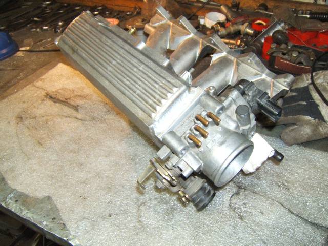

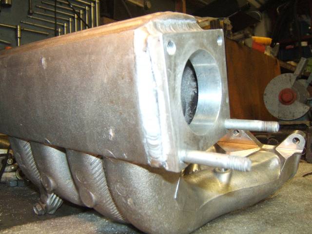

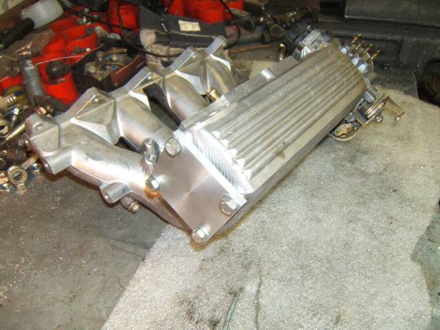

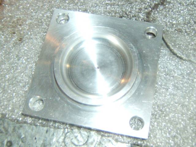

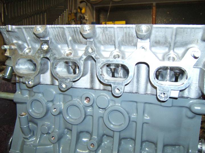

Smallport intake modified to fit AE86

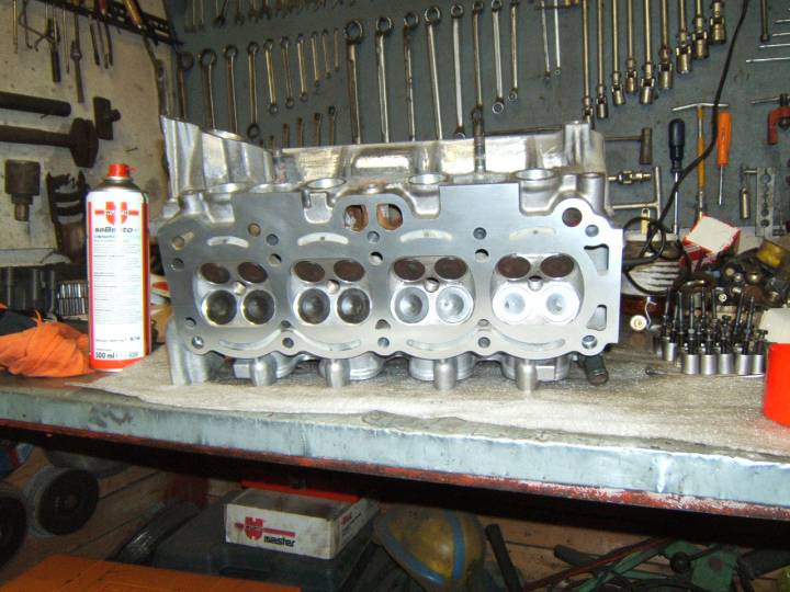

01-01-2007, 11:15 PM
Post: #74

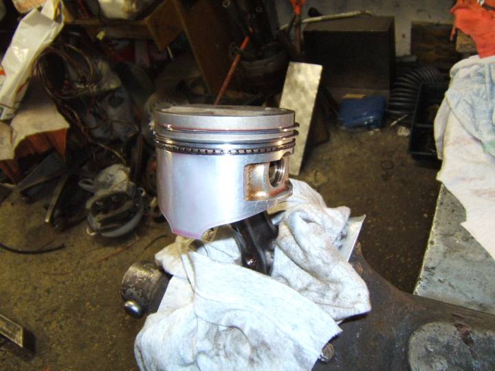

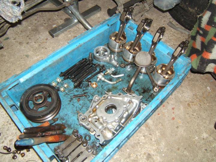

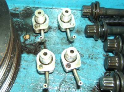

Engine parts cleaned

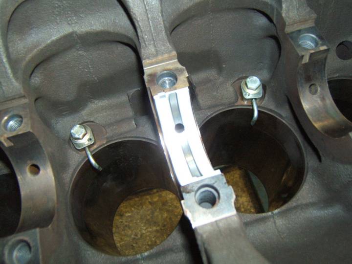

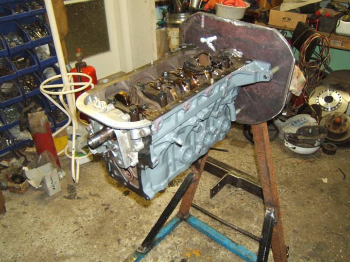

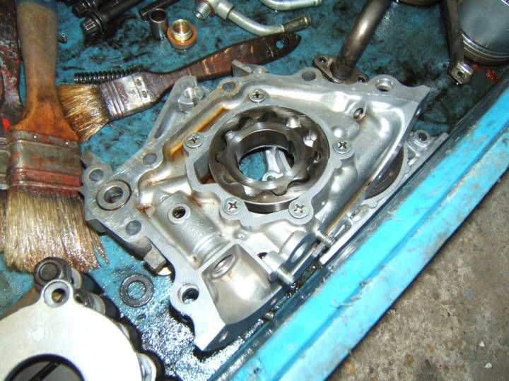

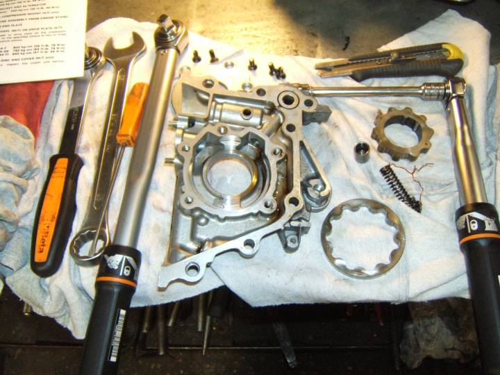

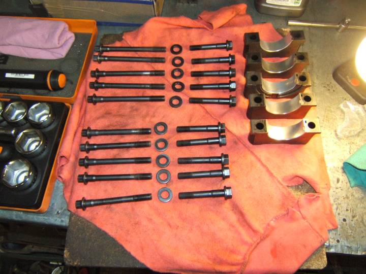

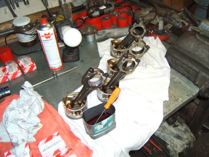

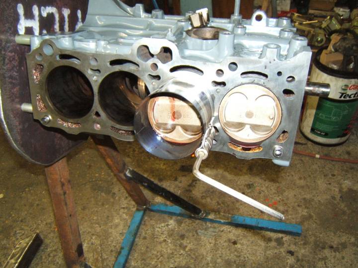

17.03.2006

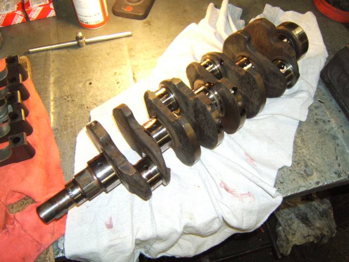

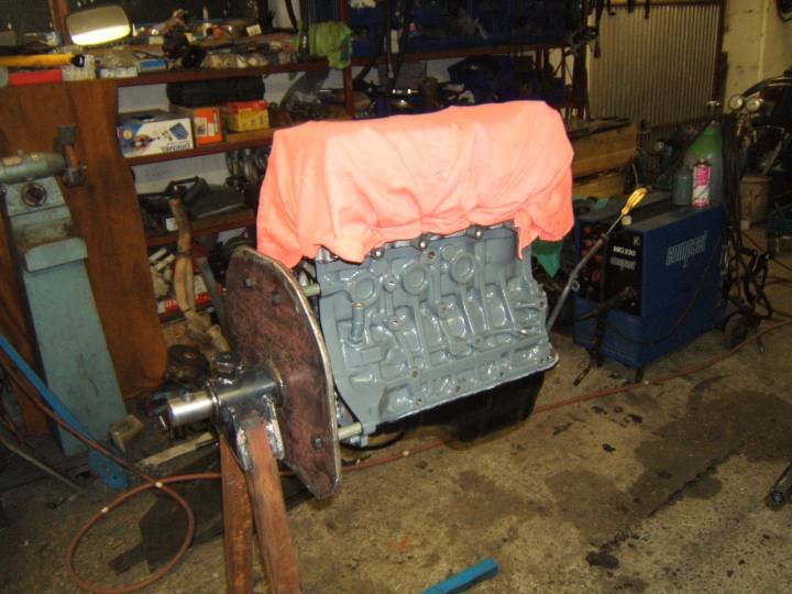

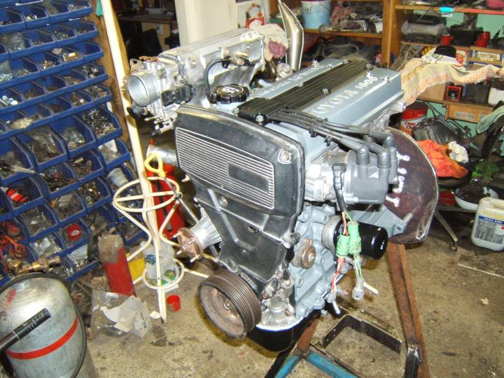

Engine assembling ![]() ![]() ![]() ![]() ![]() ![]() ![]() ![]() The oil pump had no wear so I decided to use it against a new one. ![]() ![]() Sleeping engine ![]()

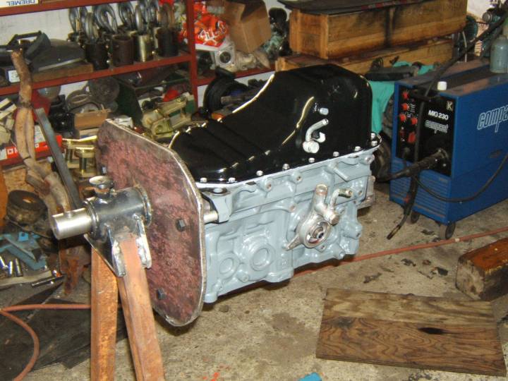

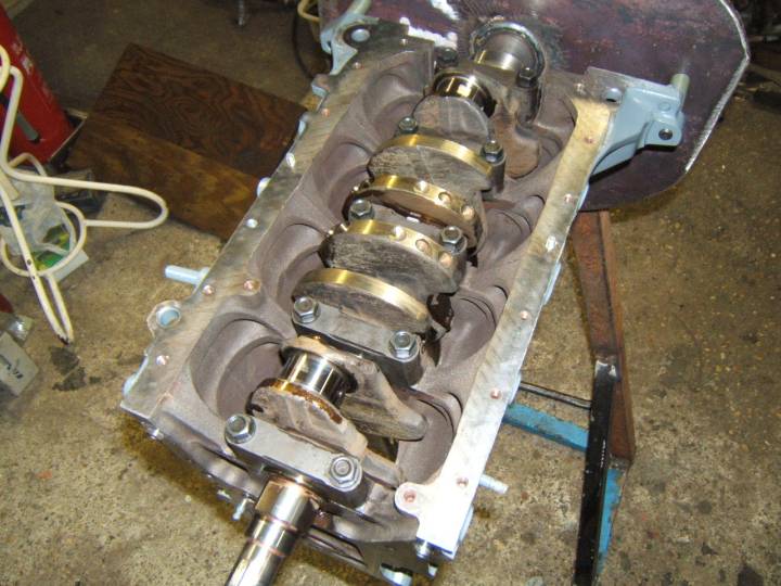

19.03.2006

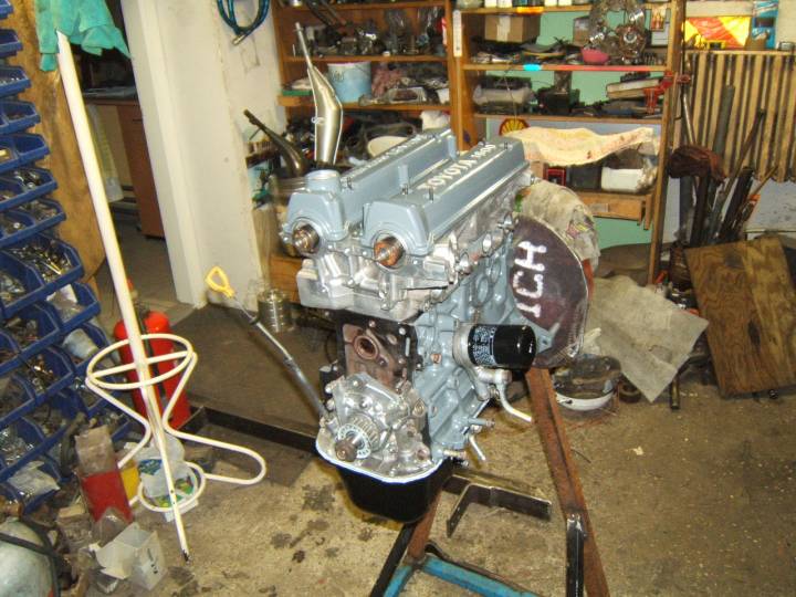

Engine assembling #2 I had time to do it only in the nights that's why I did it on several days.. Daytime I had to work. ![]() ![]() ![]() ![]() ![]() ![]()

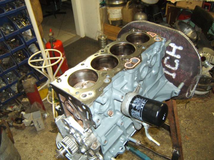

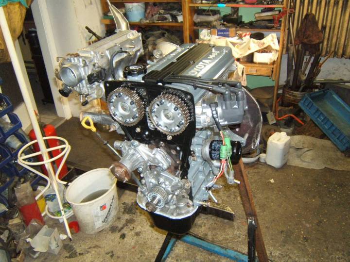

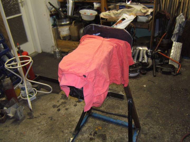

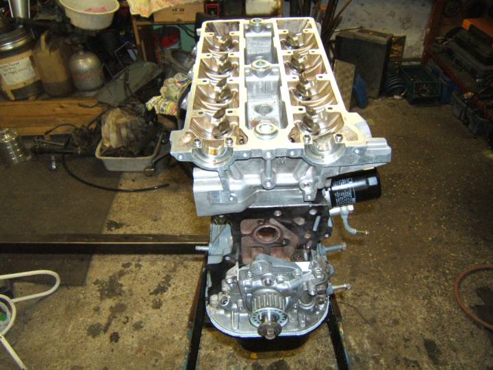

21.03.2006

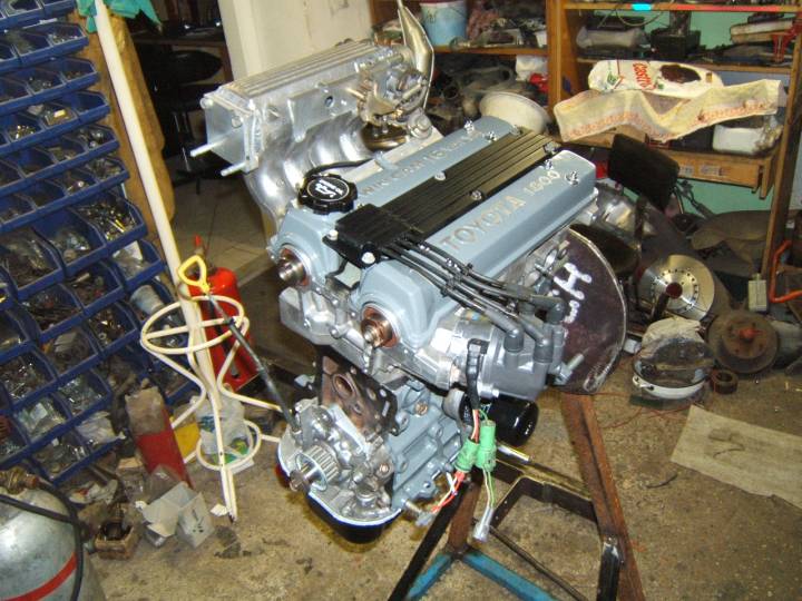

Engine assembling #3 ![]() "catched" moment of me ![]() ![]() ![]() Engine is 'ready'

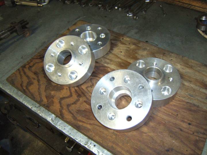

29.03.2006
Alu parts collected for anodizing ![]()

That's a goodlooking engine you built. Hope it runs nicely too, but then most 4age's do.
