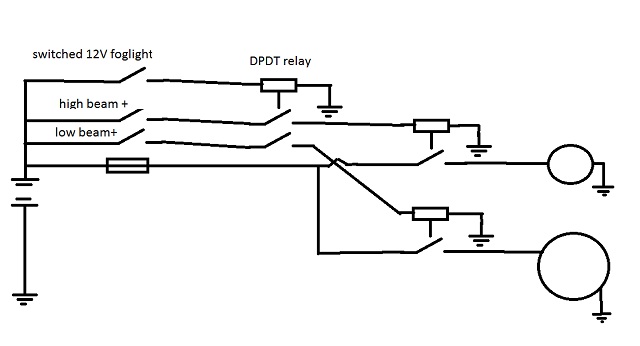

I have a wiring diagram here for wiring in 4 spotlights to the front of my AE86, it works with full and dip beam however it is on the whole time along with the headlights.
[Image: AEU86 AE86 - Wiring in spotlights (Cibies)]
Id light to wire it up so that the full and dip work in the spotlights however they only turn on when the glass grill foglights are turned on.
Would someone be able to explain how to do this?

That diagram appears to idicate thatyou use two auxiliary relays to
switch the spots. One relay is triggered by the headlight "high beam"
being turned on i.e. you tap 12V off the wire taking 12V to the high
beam of the headlights. This one should turn on the "high beam" of
the spots.
The second relay is triggered by the wire taking 12V to the "side lights"
whatever they may be ?? If, in fact, your spots have a high and a low
beam, then this wire should (presumeably) turn on the low beam of
the spots. However, to make sense, if you want your spots to be on high
when the headlights are on high, and to be on dip when the headlights
are on dip, you should trigger the second relay off the 12V feed to the
dip filament in your headlights Smile
Key thing here is that you need to have wired in two new relays.
Cheers... jondee86

Hi Johndee cheers for the reply, yea I have a good understanding off the diagram and how to wire it, my question is I want my spots to work like the ones in the diagram however I want them to only be active when the spotlights are turned on. would this be possible?

You could get yourself a double pole double throw relay (dpdt) and wire the 'headlight main beam' and 'sidelight +' wires through the switches. Power the coil with a 12v signal from your grill foglights and the spots will only be able to come on if the foglights are on.

Thanks for the reply, its maybe a bit much but would you want to do me a diagram something similar to the one above explaining? Im pretty useless at this kind of stuff! Thanks
09-15-2010, 08:13 PM
Okay, but it looks more complicated than it is.
I must correct a little error in my last post: you need a dpdt relay.

i drew that diagram origionally. the sidelights are a small 5w bulb which comeon with the cars sidelights. i put them on a relay ast they kept blowing the sidelight fuse on the car as there are 4 of them.
what you would need to do is just take the wire 86 main beam relay to the positive on your grill fogs
