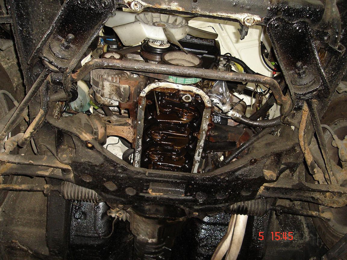

But you need to remove the oil pan. That means - engine out of the engine bay.
05-05-2005, 10:55 AM
Wierd Dyno result
Why take out the engine, when you can remove the oilpan with the engine in the bay? Confused
05-05-2005, 10:57 AM
Wierd Dyno result
Knudsen Wrote:Why take out the engine, when you can remove the oilpan with the engine in the bay? Confused
Can you ? I cannot.
05-05-2005, 11:00 AM
Wierd Dyno result
you cant Knudsen coz the engine stands on the front crossmember and not on tne chassis, which (crossmember) has to be removed if you want to remove the oil pan..
05-05-2005, 06:16 PM
Wierd Dyno result
Apolan Wrote:you cant Knudsen coz the engine stands on the front crossmember and not on tne chassis, which (crossmember) has to be removed if you want to remove the oil pan..
Really..... i cant.....?
MuHaHaHa.. Evil
The only thing you have to dismount, is the gearbox brackets on each side Wave
The enginemounts isnt attached to the oilpan :wink:
