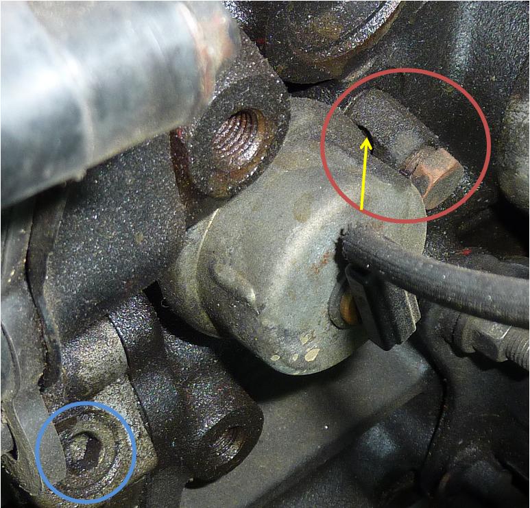

Hello,
I'm wandering what's the purpose of plug in the red circle? And more important... can it be used for a oil temp sensor? It also has a hole (around 8mm?) at the area of the yellow arrow. I read in another topic that the oil temp sensor can be installed via the plug in the blue circle also but there was some rare threadsize or something. Thanks a lot for the info. |

No!!!
That´t the coolant draining plug for the block. Why don´t you run a t-piece from the port where the original pressure sender sits? IIRC the thread is 1/8 NPT 1979 Toyota Corolla KE35 1983 Toyota Corolla AE86 1985 Toyota Corolla AE86 |

I guess that's the best option since the other one doesn't even have oil behind it...

fax0815 Wrote:IIRC the thread is 1/8 NPTWRONG !!! It's 1/8 PT (or BSPT, it's the same thing) NPT is an US norm, absolutely NOT the same thing ! BSPT = British Standard Pipe Tapered NPT= National Pipe Thread Tapered |

Thanks to all,
No worries about correct thread size I will take the sensor to the shop anyway. I will post the final correct answer :wink: @fax0815 I know my engine is not that fresh anymore (almost 200.000km). I run 10W40 Kroon-oil Emperol. But consumption is [u:dd02500c18]suddenly[/u:dd02500c18] high and just after I installed the alloy sumpguard. That's why I was wandering about oil temp. Anyway I bought temp gauge already so I will continue installation. |

Project D Wrote:fax0815 Wrote:IIRC the thread is 1/8 NPTWRONG !!! Sorry, just remembered when I fitted my defi gauges, I had the same problem, but you´re right its bspt, cause the defi sender bolted straight to the block ![]() 1979 Toyota Corolla KE35 1983 Toyota Corolla AE86 1985 Toyota Corolla AE86 |
