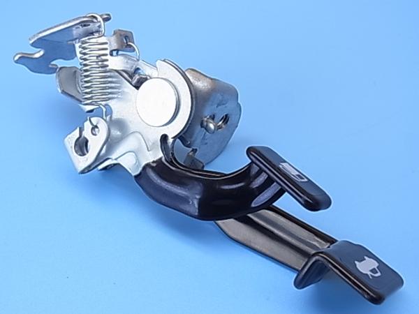

Hey guys,
Have the two cables here and looking for the handles...
But, i've checked both trunk and fuel lid... I can't figure out how they open with cables...
Can someone show me?!
Cheers

As you can see, you will pull the cable out by pulling the handle upwards, then on the other side of the cable will be attached to this fuel door opener or the trunk release:
[Image: AEU86 AE86 - Trunk and fuel door cable]
It will pull the black pin inwards, where the black pin keeps the fuel door shut by retaining the lock latch. That's also another way to open it if the cable fails: just open it using the lock.
As far as I know all AE86 boot locks have the ability to be opened using the cable.
