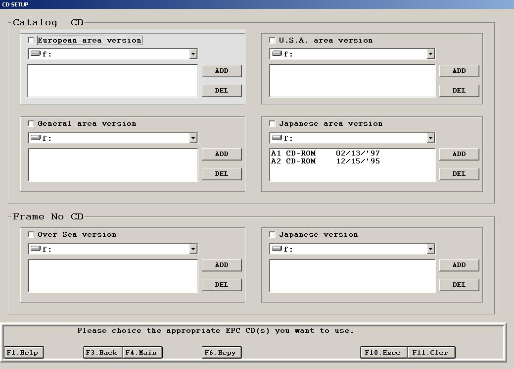

okeey in this screen I should install the english setup if im not mistaken..
This is where i run stuck.. Dont know what to do... Sad
[Image: AEU86 AE86 - Toyota EPC]
05-15-2007, 06:50 PM
Toyota EPC
I would first try getting the euro cd's to work.. those are the ones I used for my installation. Make sure you name the cd labels correctly.
The screen you posted looks okay.. you should do about the same for the euro install.. choose a1 and a2 cd's.. then press exec button (which is the 'enter'button of epc).

hmm maybe thats the problem.. what cd label name did you use?
05-15-2007, 07:52 PM
Toyota EPC
idd ik heb een verkeerde cdlabelname....
3) The EPC1.zip files should be burned to a CD with the label
"19950622E1"
4) The EPC2.zip files should be burned to a CD with the label
"19950322E2"
