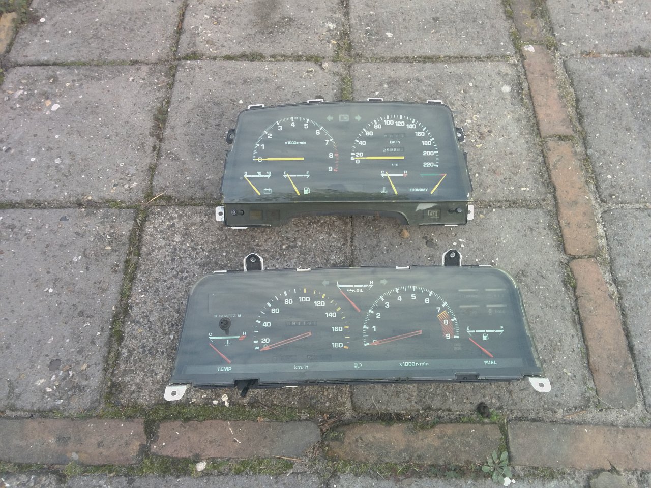

[Image: AEU86 AE86 - The A6 Celica/Carina topic]
But keep in mind that the Celica cluster has a different size. You can clearly see the difference between the two: the Celica AA63 cluster is more square while the Carina AA63 cluster is more rectangular.
If you have a whole Celica dash it could fit though.
BTW: the EU Celica AA63 cluster does not have an oil pressure meter.

If you are in need of a Celica AA63 cluster, I have one for spare:
