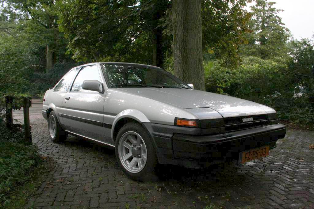

From experience I know my ae86 did not have any rubbing problems with 195/55 R14 on those CS rims.
The L-type 15 inch I currently have on my Carina do have a different offset (+20 instead of +8 ) and don't have rubbing on the inside of my Carina with 195/60 R15.
The 7 inch should have 1 millimeter less clearance on the inside and should be extending 2,5 cm on the outside. I can mesure if 2,5 cm should give you enough clearance on the fenders. Smile
I know from experience that 185/60 R14 does fit on those 7J:
[Image: AEU86 AE86 - The A6 Celica/Carina topic]
And 165/50 R14 is also possible and should give you a nice stretched look. Thumbs up!
