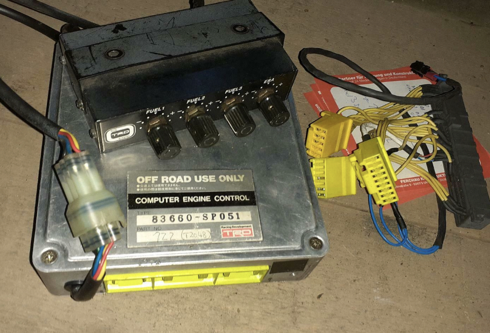

i need some assistance. I got my hands on a trd ECU for my 4age. Came of a ae92 but my problem is where to find the inner switches to set it for ae86.
I found the plan here in the forum so verry nice Hurray!
ECU Number is 83660 - SP051

Yesterday evening i found the switches to set for ae86 they are under the metal.
So there are many options group a or n1 specs due to my specs its more group a i guess.

Yes I found the manual here in an older post super cool.
I will also try to get it running on Saturday.
The Switches are set for 4age and ae86 group a which is the nearest to my mods. n1 would be to hard for my car.

Yes perfect. I do my injectors new and than Ill try it again. Maby with car model AE86 and spec blank the last time I tried it with spec group a but car run like shit...
I´ll give it a last try otherwise I will sell it or it gets a place in the living room
