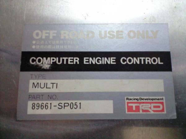

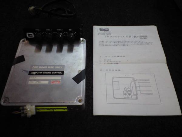

Hi Guys
After info regarding this ECU
[img name=]http://www.aeu86.org/files/tr/trdae86ecucontroller02_178.jpg[/img]
[img name=]http://www.aeu86.org/files/tr/trdae86ecucontroller03_265.jpg[/img]
I have seen a couple of posts on club4AG including images of the manual. Am keen to get a scanned copy of this if possible.
Also trying to find out whether I need to use low resistance or high resistance injectors. Going by the TRD bible, I gather I need 250cc injectors.
Jondee I see you have some knowledge of it.

I have a copy of a copy of a copy of the manual Smile I'll take it to work
tomorrow and see if it scans up OK. Under the engine spec section for
the 4AGE (N1) it indicates...
Head gasket 11115-AE812
Comp ratio 10:1
Standard AE86 injectors (JDM Levin spec I guess)
Spark plug #31
Air filter element and intake resonator removed
Exhaust system N1 spec (from factory cast section)
I'm not sure what class of racing they are referring to when saying N1 ??
My recollection is that N1 was a higher spec than Group A, and that the
engines were pretty much TRD everything. Maybe there was another "N1"
with a spec closer to factory ?
EDIT: My bad... was getting mixed up with N2 Blush
In any event, I am led to believe that the Multi ECU was designed to
work with a specific set of engine modifications. However, the manual
does not contain any details beyond the above.
Cheers... jondee86

Yahoo Japan. Very shiny
The photos above are ones I pulled off the net for convenience.

With you running slightly different cams, and the ECU's dial adjustability....
You might get yourself a wideband and use the wideband information to make your adjustments.
