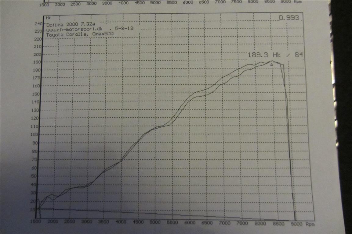

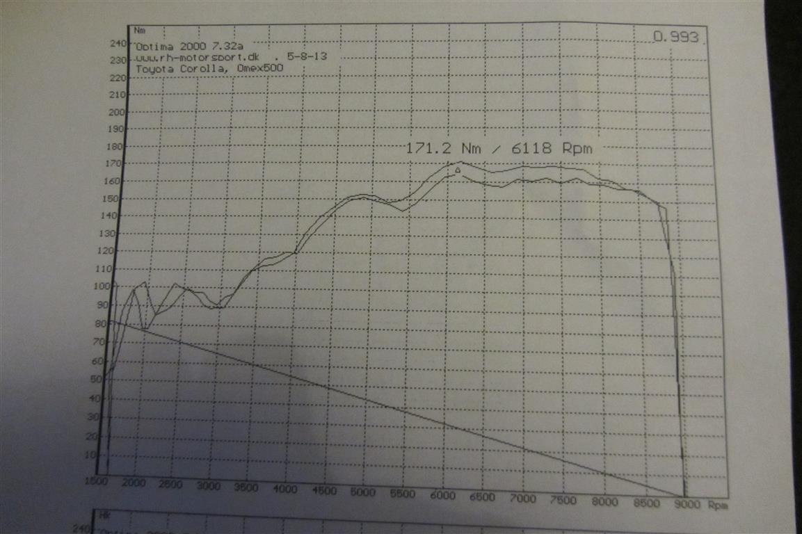

Engine finished on the dyno... Result somewhat different than expected. These cams was bought 2. hand as ~280 - dont think they are... Huh

That's making good torque high in the rpm range... I would be happy Smile

08-06-2013, 02:42 PM
Strange moment curve
I don't know what you have expected
but this are low lift cams with duration, then you get power in the high rpm range
and not a masive torque
