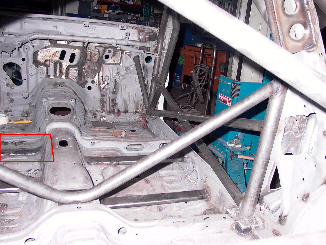

I am also about to build my new shell and I was wondering how to weld the pipes for the seats on the floor without sitting to far away from the pedals, cause of this bar on the middle of the floor. I saw you just cut it off. Don´t you think it will make the body to weak at this place?

Cut it off the bar on the floor don't will make the body to weak at this place because the pipes for the seat are very strong and are welding to the floor.
The pipes are the same material of the rool cage more stronge than the bar.
I am a standar Spanish body size. 1'72 meter tall and 70 kg.
Everytime OVERSTEEL!!!!
