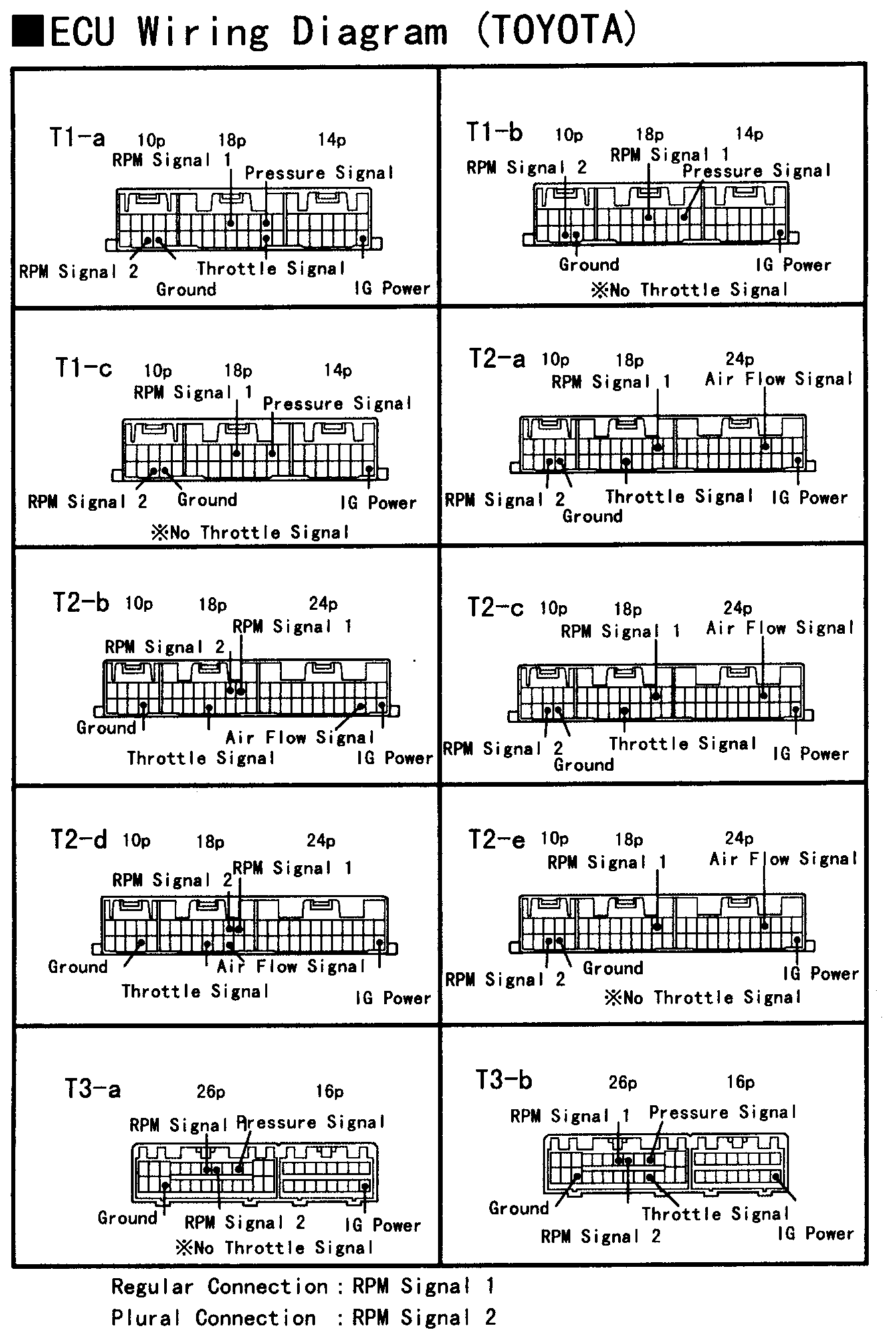

Need some help here guys... Dumb question
Using the APEXi manual can anybody tell me what type of ECU is mine? According to the manual it is a T1-c but i can't find in the 18p socket of the ECU the Presure Signal cable ... there isn't one there in mineDumb question
Any help?
06-09-2005, 11:11 PM
Settings for APEXi SAFC???
Well, from here i can clearly see the pressure signal in the t1-c ECU....? So i dont quite understand your problem...?
BTW, i used the diagram for Mr2, cause the manual says that theres no throttle signal in AE86.. And thats a lie :wink:
06-09-2005, 11:14 PM
Are you sure, that your engine is an mapped one? If you have AFM, its probably not the same diagram you should use.
