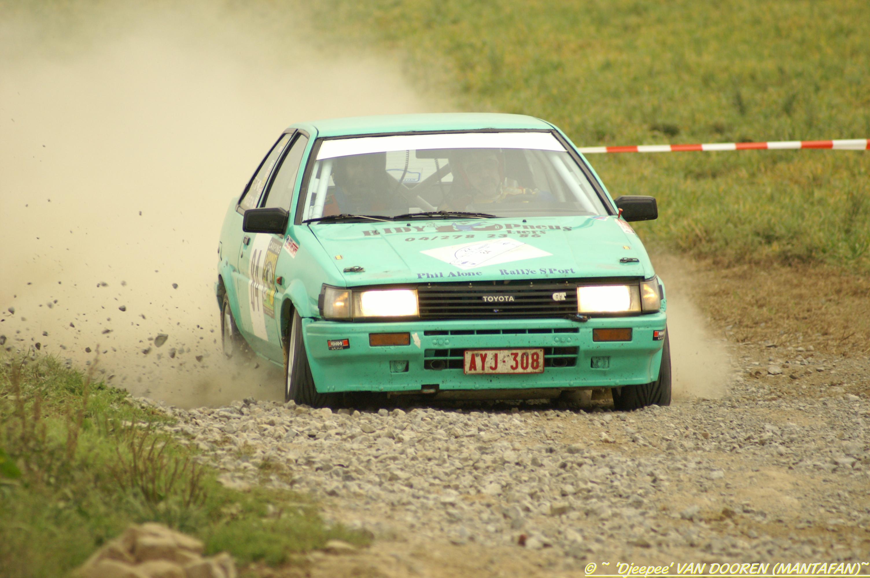

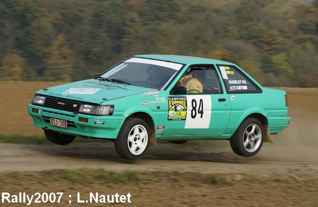

When I bought the car , it was fitted with selfmade coilover welded on stock strut . Easy to lift or lower the front , but pretty hard to keep the car on the road . My ae86 was acting like an fwd , despite all my settings .
When I fitted the stock strut , i use the same blue Tokico , with genuine springs , broken after two rallies . I had springs machined with a wire dia of 13mm( I think stock is 11,5mm or 12mm ).
On my last rally , I've been a bit optimist on gravels road and what happend?
strut , shock and spring were bent.
THat's why I want stiff springs .
See the pics :
first the optimist ride
second : look at the front right wheel
Filh

Hiya Phil,
Could you post a pic of the bent strut? Just to see where it is bent?
Springs should never carry any lateral load..If they do, then most of the times its because everything beneath it (strut) is already bent.
11-18-2007, 12:48 PM
Searching for front springs (rally)
i am interested too,
but if its stock strut then the springs are not in the centre and the outside side of the spring support can be bent more as its farther from centre, load is higher.

Stiff springs on gravel will cause a lot less grip. And I think they will break too when the entire strut does.
