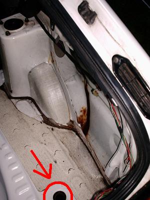

12-22-2006, 08:03 PM
SR Levin hatch from Prague, CZ
Are you sure you're looking for the right bolts? You shouldn't try to unscrew the bumper supports from the bumper but rather unscrew the bumper supports from the car.
On my car and the E9 (and I guess it should be the same for the AE86???) it is pretty easy. There's two rubber caps on each side of the spare wheel under the carpet that you have to take out. Under each cap there is a bolt that you have to take out. If you have the small bolts and supports on the rear fender out you can just shift the whole bumper backwards.
12-22-2006, 08:08 PM
These are the caps I mean...
