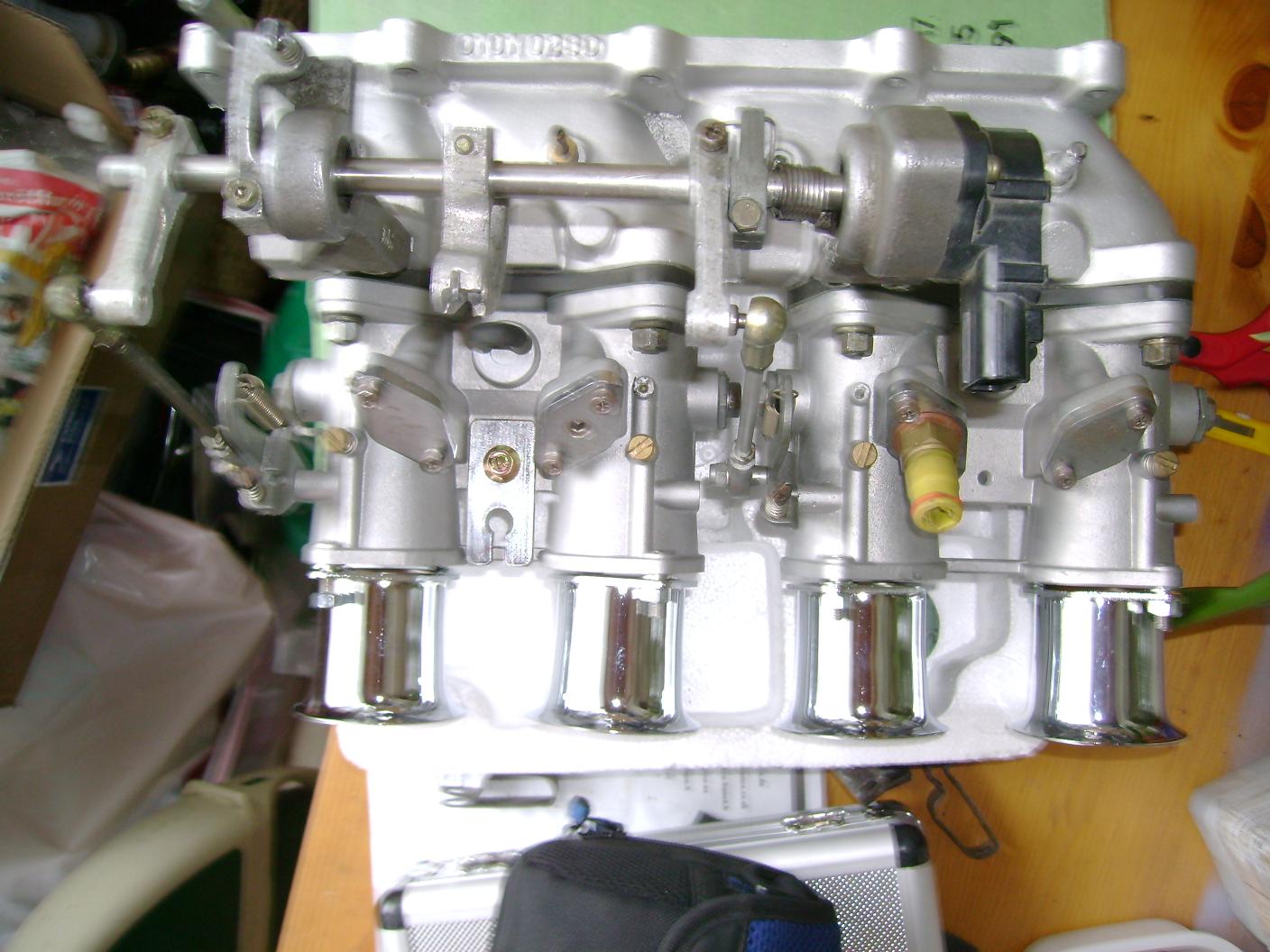

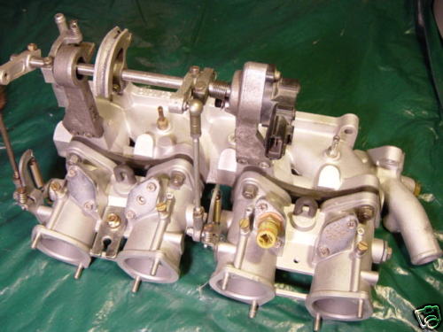

Hello,
i have bought a used Kit of SK ITB´s (see pics) and would need some infos about it. BigportAdapter, Waterpipe were incl. Does anyone here have such a set? does anyone have a manual or something similar? any infos for install? every info would be fine! thanks and greets from vienna, martin |

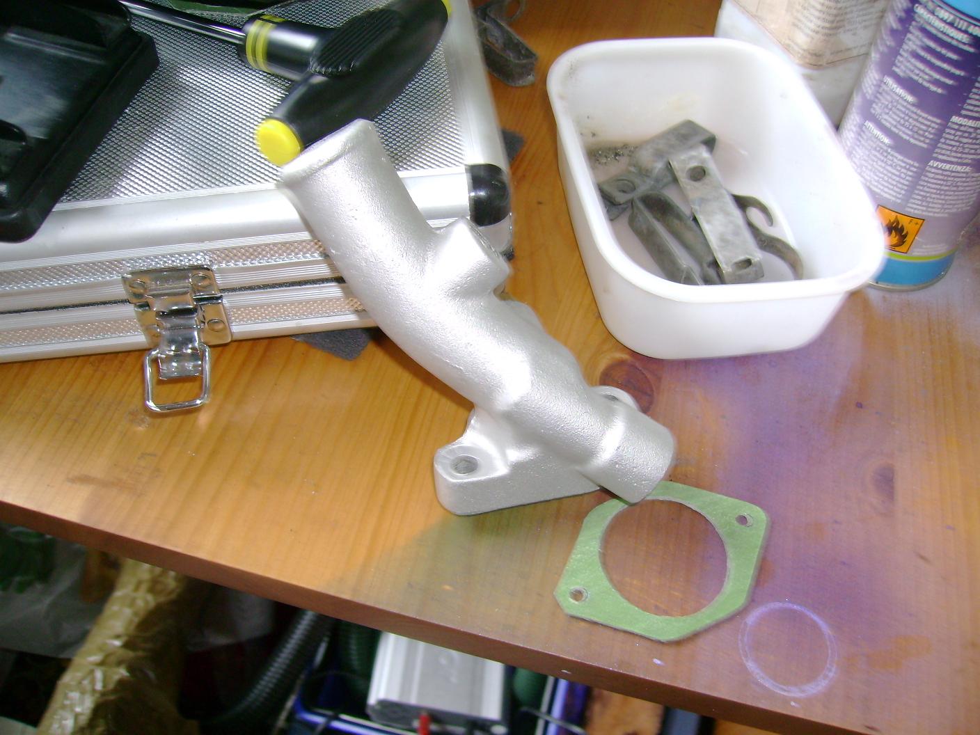

Hello,
first thanks for reply. for me it seems that this setup is just plug and play as it has the stock TPS, isn´t it? i know how to balancing them, thats not the problem. what i would like to know is, where to connect the vacuum hoses ( from every cylinder to vacuum tank and from tank to map sensor?) have u got some pics from you setup, just as a little help? will u run it on stock ecu? i mailed to Mr.Yuiko Funabiki from Tatsumi Company (OER Parts Supplier), he send me a email with spare parts, there is a part i dont have incl., its called Idle Up Body (see pic), do i need this? i think this is only for carbs, isnt it? thanks and greets from vienna, martin |

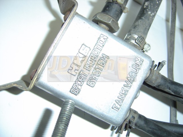

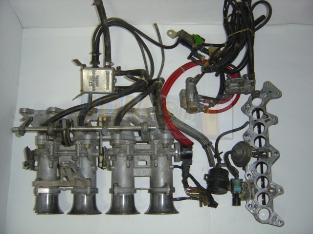

Quote:Yes it should be plug and play, it will run with the stock TPS and it also has the IAT fitted – only other thing would be the Map sensor. does your kit have an other MAP Sensor incl.? i have seen an old HKS ITB kit (see pic), which has an other MAP sensor incl.! the plenum is not the problem as i make one on my own! Quote:You also need to incorporate the vacuum feeds for things like the fuel pressure regulator this is something i got no infos about!!!! Quote: Personally cant wait to get these on my car, need some shorter air stacks though as mine are way too long. Holding out for some sexy carbon ones! I know exactly what u mean, i also cant wait to fit,hear and feel them and i have to wait until my car is street legal on the road again (maybe april). for me this setup is the perfect way for a conversion. thank u so much!! will wait to hear and see some pics. from u. greets martin |
