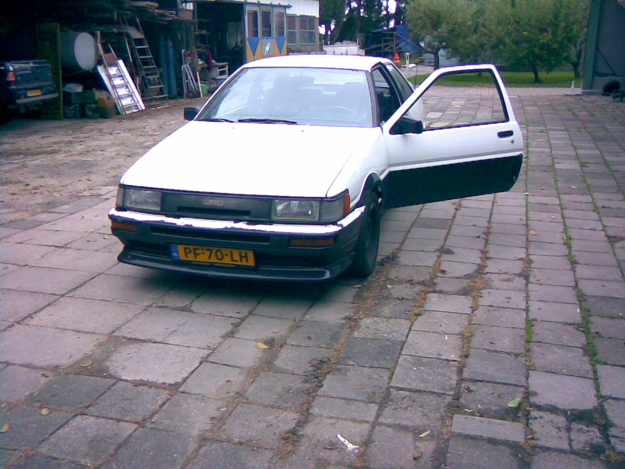

Confused Pulled my car from the storage today ...... It doesn't look as bad as I thought it would be but not as good as I hoped for ....
Car defenitly needs a bodywork specialist. I'll be searching one so that when the racer is finished I can drop it of pay money and get it back the way I want it.
For now I will use the hachi again but this time just for the fun stuff. Got some track days comming up. Man I missed that revving engine!
