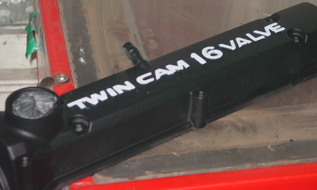

07-04-2005, 08:20 PM
Robokill's Panda Levin Coupe!
Okay, here we go. As I already mentioned, the end result isn't completely great cause I made some mistakes along the way, one of them being doing this in a stuffy shed. I really need to make some sortof paint booth where I can have things dry safely..
So I got these red painted valve covers from Robokill. Now this paint that was on there was made to last!! Sandblasting with my little DIY sandblasting equipment was tidious to say the least. Eventually I did resort to messy tools and first got most of the paint of with a wirewheel and then sandblasted it.
The nice thing about sandblasting is that it gives you a nice finish that is a little rough, perfect for spraying, but also perfect preparation to just polish it after you sandblast. It doesn't scare the surface like a heavy duty wirewheel does. This is also the reason I used a more gently wirewheel on a drill that doesn't scratch the metal as much.
07-04-2005, 08:22 PM
Robokill wanted his valve covers black with white letters to match his white and black panda paintjob he's been planning for awhile.
So I started with painting the covers white....
07-04-2005, 08:25 PM
Okay, next step is to do the black. What I did is to brush some greasy stuff on the letters so that the paint would not adhere to the letters and I would be able to wipe it off cleanly. That worked pretty well.
What didn't work all to well is that I was doing this when it was getting dark outside and I never noticed I didn't paint the sides to wellSad I had to redo the sides later on...
The other thing that didn't went to well is that at this point dust was settling on the paint as it dried. That is also something you don't see to well in the dark with dark paint, but once the gloss went on..... Sad
07-04-2005, 08:29 PM
Lennert already saw them in this state and also at night Evil but they did look nice. Yesterday I finished them off, taped off the letters this time as it was already black around them and just repainted the sides.
The trouble was though that the difference between the two blacks did show because one was already glossed and the new paint wasn't. It took me alot of glossy coats to get them to match up and now you really need to held the cams under a bright lite to notice where the masking was....
Anyways, I think the end result does look stunning eventhough it has some beginners faults in them.
I'm planning to do my own soon but then I will only paint the letters, the rest of the covers are going to be polished really shinySmile I just need to get em off the car or get a second set to prepare firstSmile
