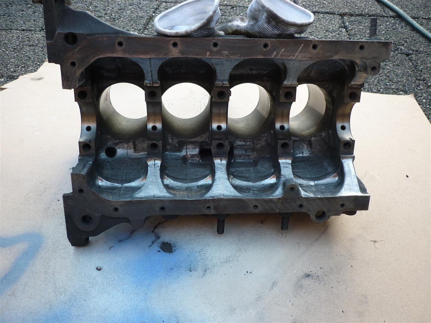

Well still working on the engine. Now with a high RPM tool.
Going to try and find some 200+ sanding grounds for my machine to super smooth it. Though this surface is already a million times better than it originally is.
I actually have no clue if this mod is noticeable but it should increase cooling and oil flow trough the engine. So that would suffice for me.
Also seems that the amount of shit that is originally on the block wall can come off gradually and damage bearings etc.
Also I send a mail to a fabrication company which does mods on 4age's for kit cars. Hoping to see if I can design and build a custom oil pan with him.
Any one ever tried making the cam covers together ? Also to strengthen the engine.
