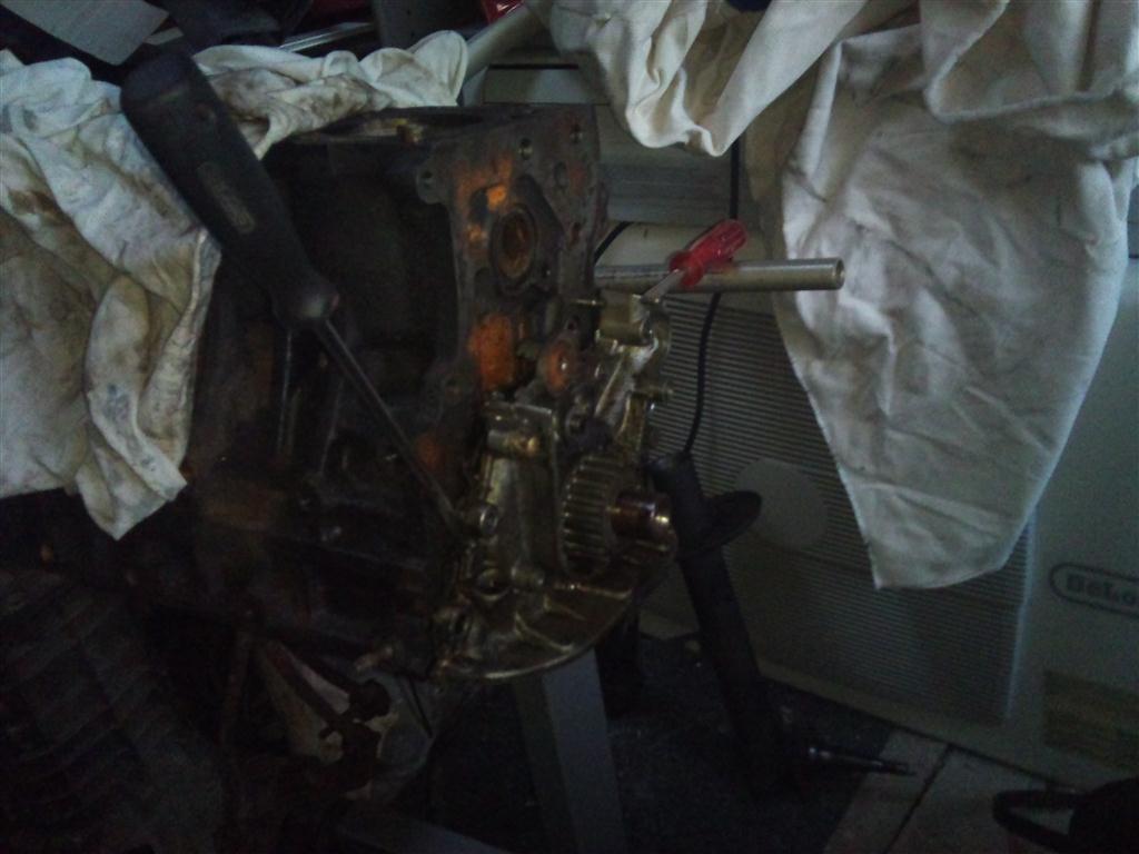

Ok 3 weeks ago I decide to stop trying and get it trough MOT. Simple take out the old engine and build a new one. Engine is still in atm to move the car around where its stored. But I began taking apart the lower block which was originally in the car.

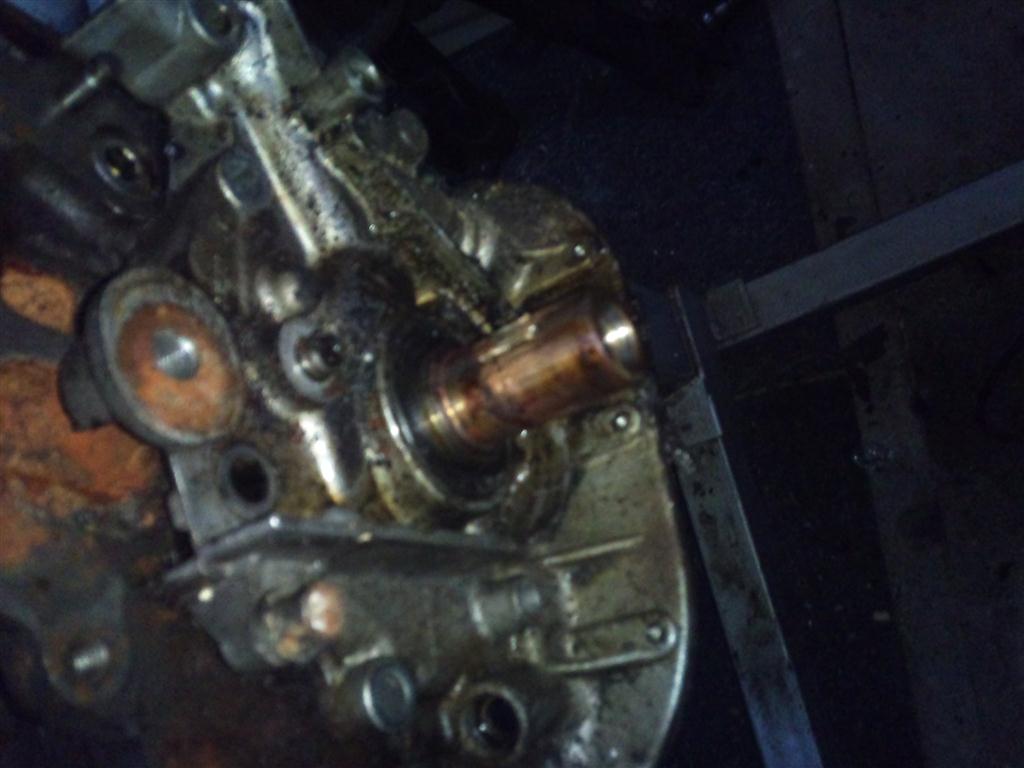

Then after some taken apart you come to the point where you have to take off the timing belt pulley. Which is always a pain the butt. But after some thought and deciding to take a new oil pump I managed to use it as a "pusher"instead of a puller. ( I borrowed a puller which of course didn't fit, go figure)
So I made some pictures because it actually went off pretty easy. Had to be a bit secure not to break it or my screwdrivers.
I first used two screwdriver between the lower block and the oil pump. Then behind the pulley itself.
PS don't look at the mess. I will clean it after the blue one is on the road

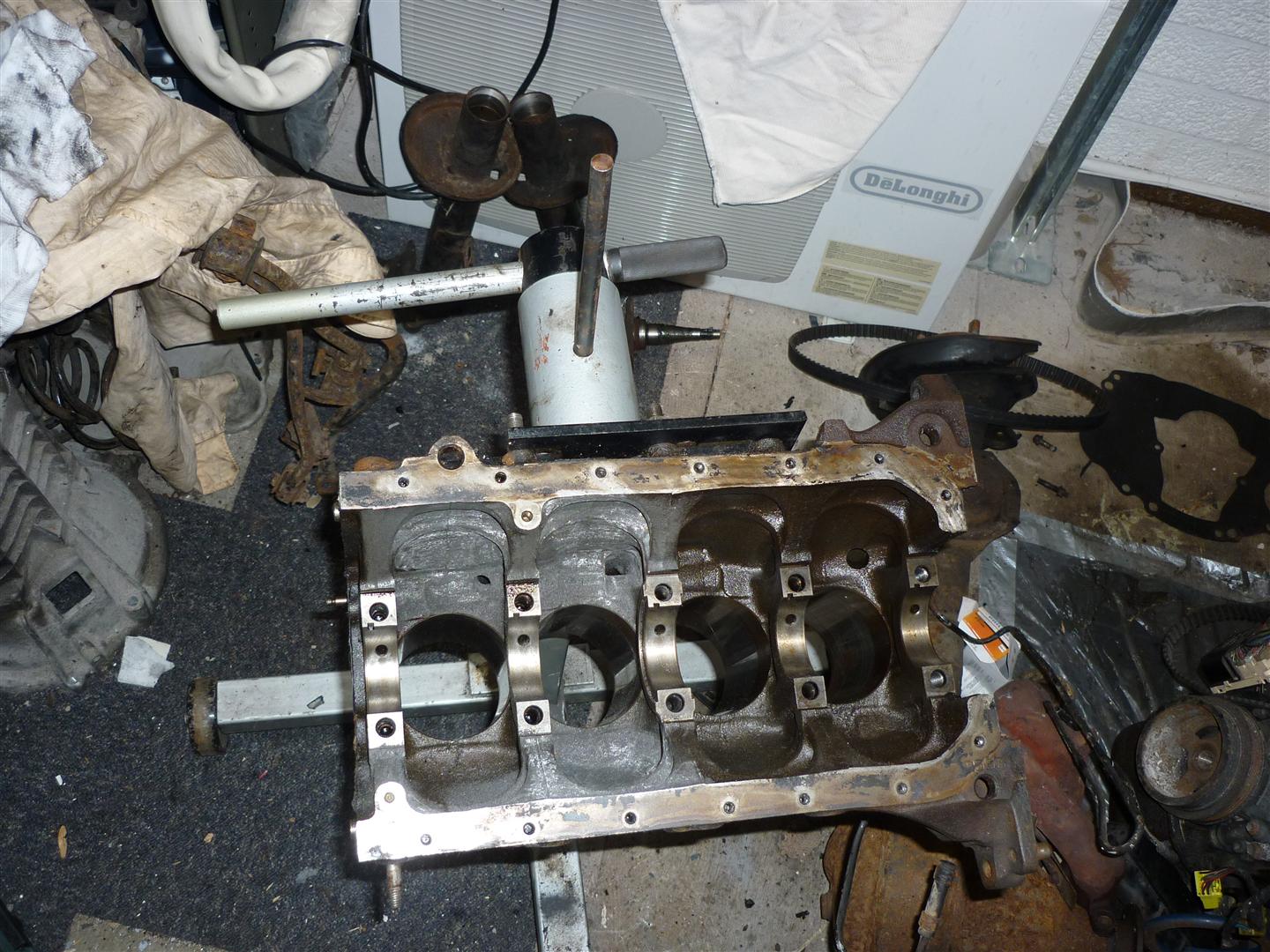

K lets sum up:
Engine is a lowerblock model nr: 10 (yes there is a model number on the 4age lower blocks)
- 40mm crank
- bore looks original (looking if I can do with honing only instead of oversize)
I will polish the lower block from the inside and remove any obstacles in the oil channels (there are some always from factory)
- rebuild lower block with new bearings and if needed new pistons. (rings etc)
- new oil pump
Lower block shouldn't take too long to refurbish.

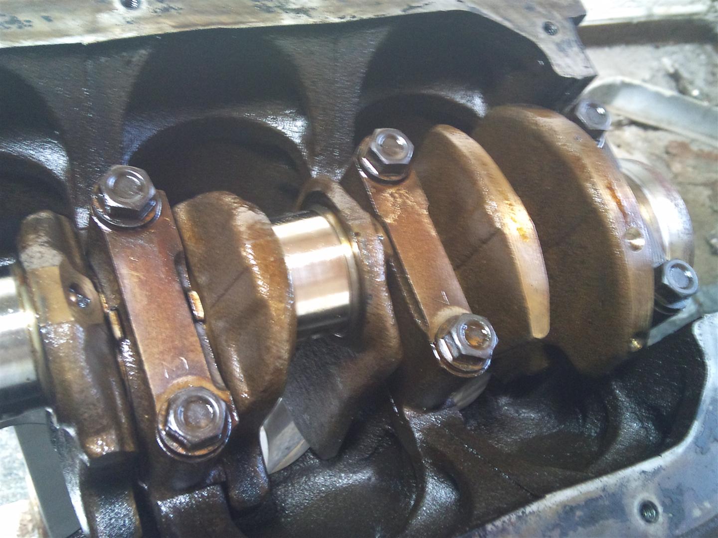

Well I ripped it apart completely and got scared while doing. I had a second look at the crank bearing caps..... They where mounted wrong.
As far as I know the bearing caps go from the front of the engine (where the pulley is to the back) in numeric order. So bearing cap 1-5.
This one had bearing cap 2 installed on the front and 1 on the second spot ?

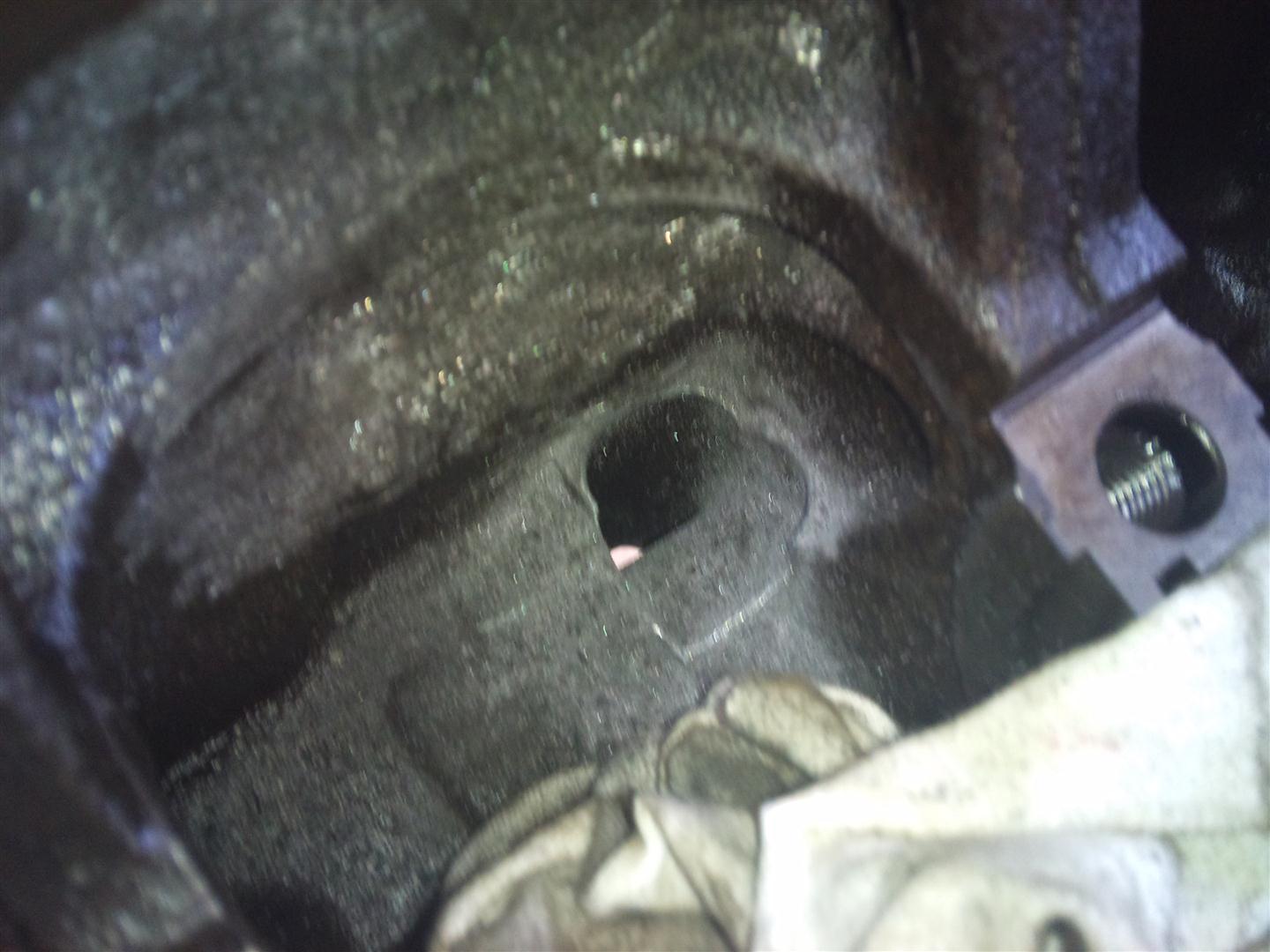

So, I started with the oil canal on the second cylinder. I talked with many people about the 4age over the years and heard that the polish of the lower block is very good for the oil function in the engine.
Therefor I started grinding the walls and removed all the up and downs from the oil canal. I am nearly done with the second compartment. Then I will do the 3rd and as last the 1st and 4th.
So far I am thinking of doing a quick simple polish. Lower block will go to the engine wash shortly after being measured and hopefully honed. (instead of overbored)

Well all 4 are done. Now I am perfecting it to make it even nicer. With a grind tip its pretty rough so I am trying to make it as smooth as possible.

Polishing the internals is a good idea.. me thinks you need to switch over to sanding flap discs to get the surfaces smoother. The idea is to get it smooth enough for oil mist to cling to it easily, but you know this. Also invest some money in a better windage tray + crank scraper if you are serious about reducing windage losses, they do a better job than polishing alone (and polishing is much more work).
