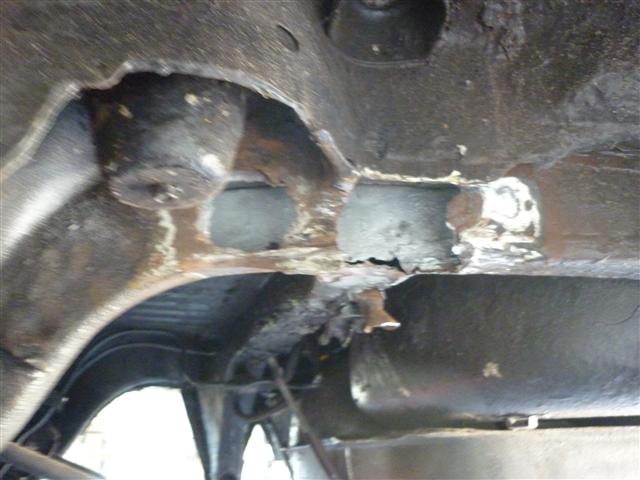

And it failed MOT. I had the following points:
- Ball joint left front failed
- Top mount was broken (the whole strut came out because the rubber let loose due to rust)
- The four links lower mounts where dented (because the car is lowerd I hit it when driving onto the bridge)
- 2 holes in my chassis... ( now I really missed these)
- Left rear brake caliper leaking
So I changed the ball joint up front. I repaired the mounting point of the lower four link. (simply hit the corner back) Changed the top mount which was fucked. (will be removed anyway)
I got a spare caliper standing by to be mounted. And started to look for holes. As the whole chassis was welded I was very curious on what I had missed. The result was somewhat shocking for me.
I don't have pictures from the other side but thats fixed already.
So, after that small set back on that. I should be ready for MOT and pass around tuesday or wednesday.
