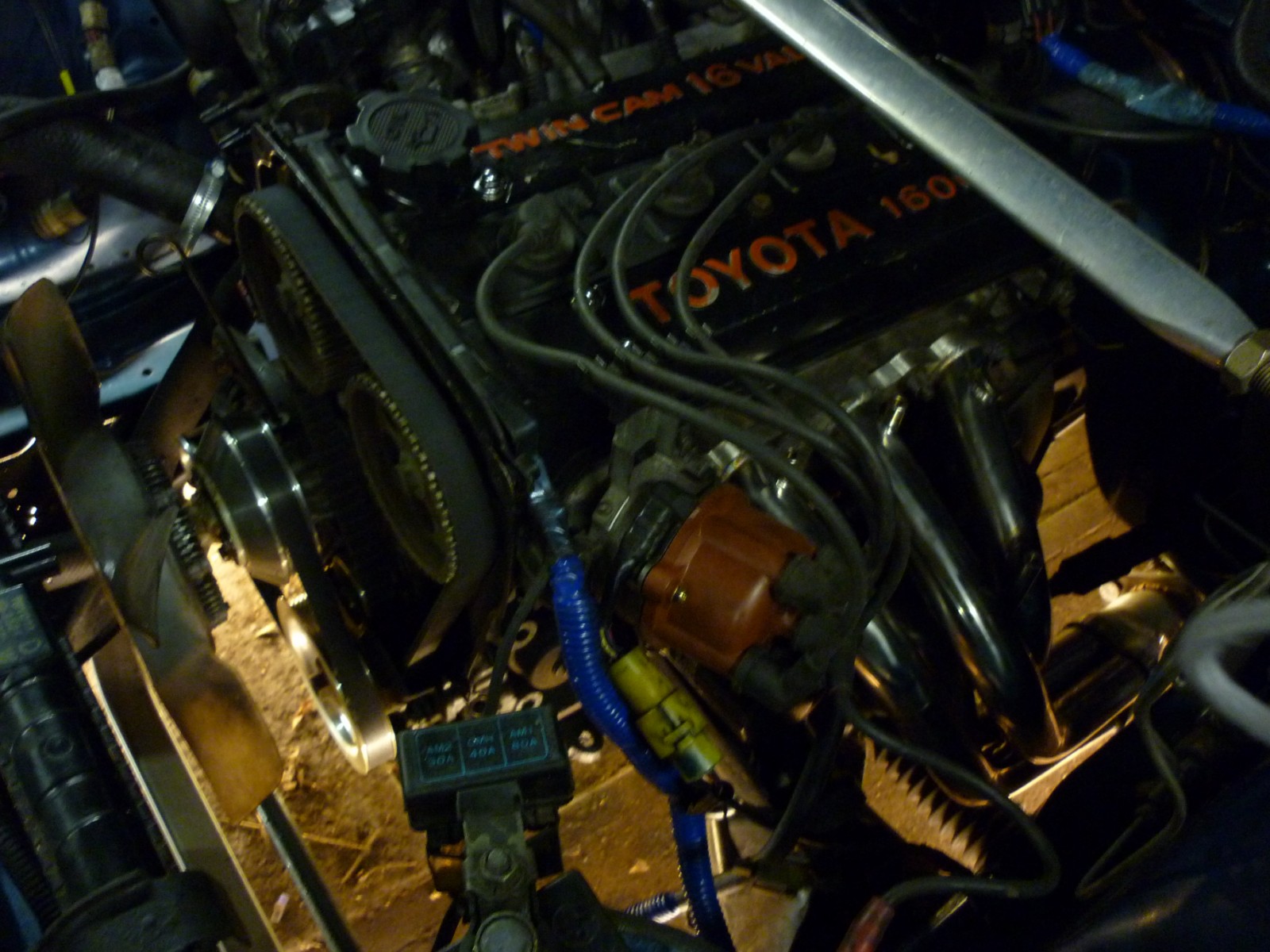

Well got my OBX exhaust completly installed now.
And Ivan came to help me the whole Saturday. To bad we didn't got the car running due to a couple of downsides.
- empty battery
- mysterious electronic problem
- grounding problem
So on Sunday I went out for another try. This time Aram was so friendly to come along.

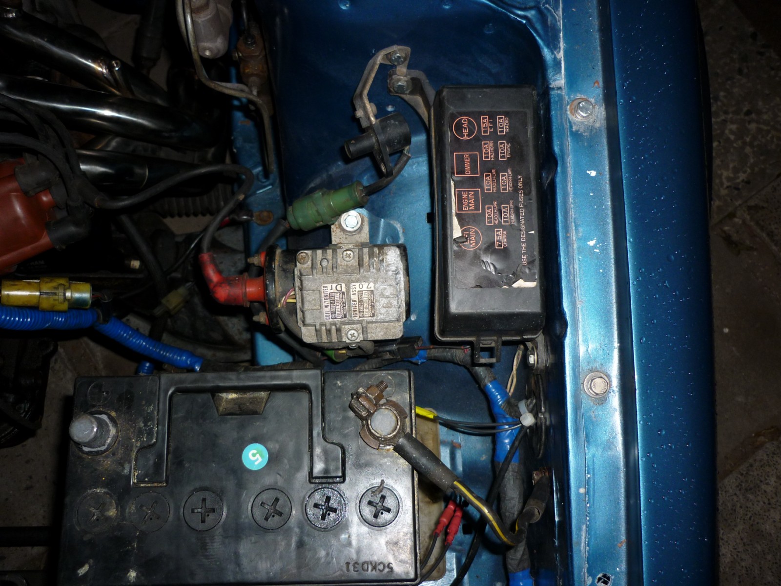

now the problem.
Engine does crank and fuel pump is running but I am missing the engine check light during ignition key on first spot.
Seems there is no connection between the ecu and the rest of the engine.
I made a movie from it.
Hope someone can help me. Becaus I am running out of ideas why its not working.[/video]

the sound in the ed after you turn the key again sounds just like when i had a shortcut in the light switch - probably not much of a help but it's defo the same sound (was apparent when the pin for the cluster had juice on without the lights themself)
I see you attached an additional ground - is the original ground that goes on to the intake plenum (thick wire where the injectors are) also attached?

We had the plenum ground connected on saturday, looks like robo moved it to the chassis.. didnt fix the problem.

Maybe You changed battery terminals? Check it.

Thank you for your suggestion, but that I'm 100% certain we did that right.

due to the busing sound at the end I guess some wireing got shorted or similar... I don't have a garage anymore to test things out as I just moved to Brussel but have a look with a current tester in the area of the drivers footwell... maybe you can locate the bussing sound and go from there
I'm not 100% sure but the sound seems to be for shortcircuited relay and switches in general... not just the light.
EDIT: don't guess you have the day off on a Monday or Wednesday? I could come and have a look...
