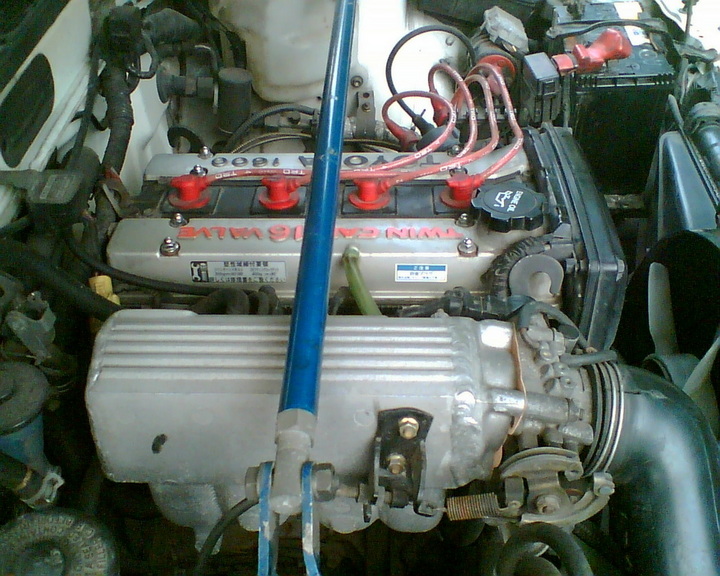

Anyone tried doing this welding job, and have info on what to watch out for?
Please supply me with pics if possible Smile

Looks like a basic cut & weld job to me. Just make sure that the throttle body flange is welded back in place at the correct angle. You'll also need to make some new holes for that throttle cable bracket.

is that my block???
[Image: AEU86 AE86 - Redtop inlet manifold modif...n for ae86]

1. Machine cutting using special bi-metal knife.
2. Argon welding.

And it would probably cost more, and make less power due to the less than ideal shaped intake track. I would prefer a cut-and welded smallport manifold myself. Some people argue that the aesthetics arent very appealing but that all depends on the amount of effort you put into the finish of you welds. (Just look at the differences in the pictures in this thread for example...)
