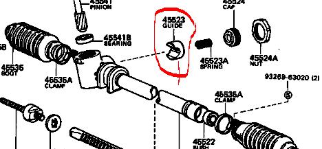

I was thinking about the rack guide (part n°:45523-20040) that might be out of shape and could'nt fit with the new main axle?

I think the guide rack could be the reason of my trouble . See the pic added . That part is as old as the complete steering rack and may perhaps be to old for the new well shaped rack.
what do you think ? I must insist , I have no steering problem with the stock parts on car.
