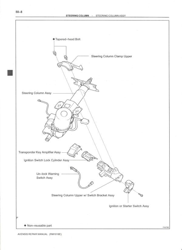

Jimmi either you go to the gym or you could ask Martin Bjerre... He used a rack from an old Carina and an electric servo from a MR2 I think. It wasn't easy but it worked Smile

I have found some drawing of the Avensis power steering motor and its not impossible. Fitting the car is not a problem - I think, its just metalwork and will just take some time.
Project AE86 now begun.
